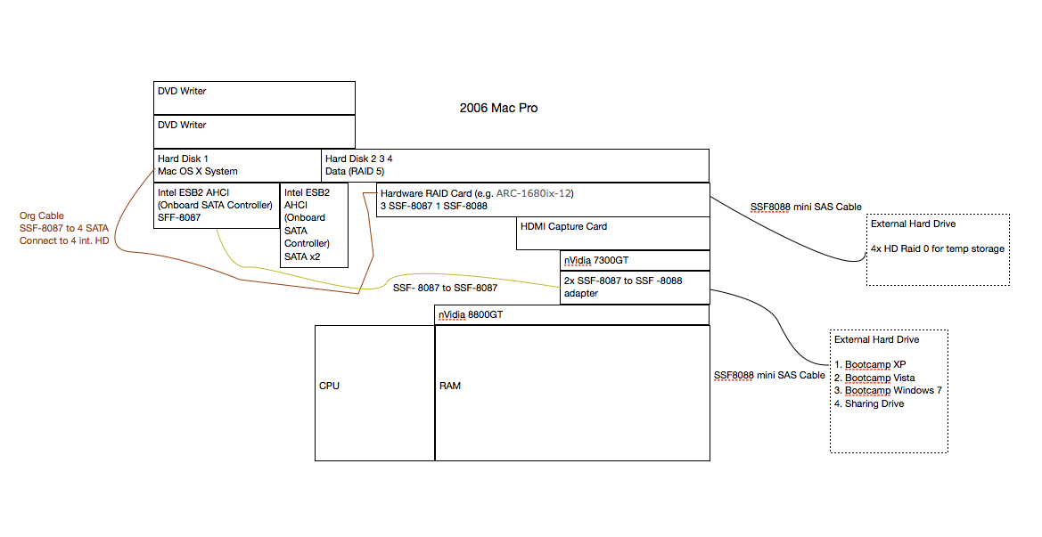

I'm planning to setup a RAID on My Mac Pro (2006 2.66 Quad Core)
I know Bootcamp not support Hardware Raid Card
Can I use the Hardware Raid Card for boot Mac OS X and storage Data, and use the onboard controller boot the Bootcamp Drive?
Here is my plan
Thankyou 🙂

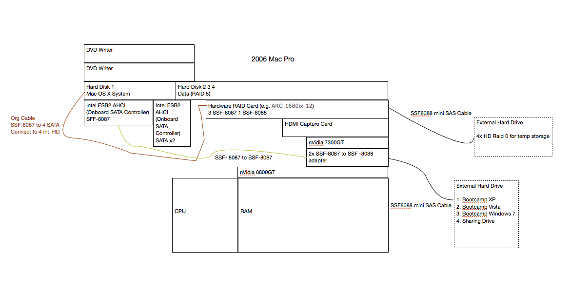

Here is my plan
Thankyou 🙂
Yes you can. 😀
As you'd be using a separate single drive for Windows, Boot Camp isn't actually needed (it's a partition tool that allows both OS X and Windows to share the same drive). You do have to use the BC disk for the Windows drivers though.
Also, for performance, make sure you don't stick the ARC-1680ix12 (8x lane card) in slots 3 or 4, which operates at 4x lanes. That really only leaves slot 2 for best operation. For stability reasons, DITCH the PORT Adapter. There's a particular cable that you should be using (SFF-8087 to SFF-8088). Make sure all cable lengths added DO NOT Exceed 2.0m for SATA drives, and use Enterprise drives with that card. Consumer models are just too unstable, so check the Hardware Compatibility List to avoid problems with drives.
Yes you can. 😀

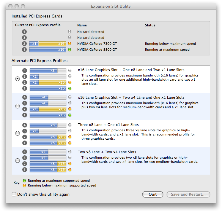

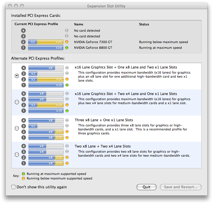

In the Expansion Slot Utility, it said Slot 4 is x8 , Slot 2 and 3 is x1
You can stuff it in slot 4 then, or change the configuration via the tool. 🙂 It had slipped my mind on the '06 & '07 having the slot config utility. 😱 It's no longer available from the '08 on, so they're fixed. 🙁
Despite the slot location, the rest of it is valid, and doable. 😉
