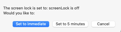

@Rok73 Thanks to some outside help 🙂 the script is fixed and can be saved as as app.
I’ll explain step by step
- Open Script Editor (/Applications/Utilities/Script Editor.app )
- Copy-paste the code below, with your password instead of 1234
Code:
set ScreenLockStatus to do shell script "sysadminctl -screenLock status 2>&1 | awk -F'] ' '{print $2}'"
set question to display dialog "The screen lock is set to: " & ScreenLockStatus & return & "Would you like to:" buttons {"Set to immediate", "Set to 5 minutes", "Cancel"} default button 1
set answer to button returned of question
if answer is equal to "Set to immediate" then
    do shell script "/usr/sbin/sysadminctl -screenLock immediate -password 1234"
end if
if answer is equal to "Set to 5 minutes" then
    do shell script "/usr/sbin/sysadminctl -screenLock 300 -password 1234"
end if
if answer is equal to "Cancel" then
    return
end if
- from Script Editor - File - Export – choose a name and the location where to save the app, File Format – Application, Run-only, Don’t sign code.
Now you can run the app and you will see these options.
The script can be modified with different values for seconds or off instead of immediate, if you want to turn it off.

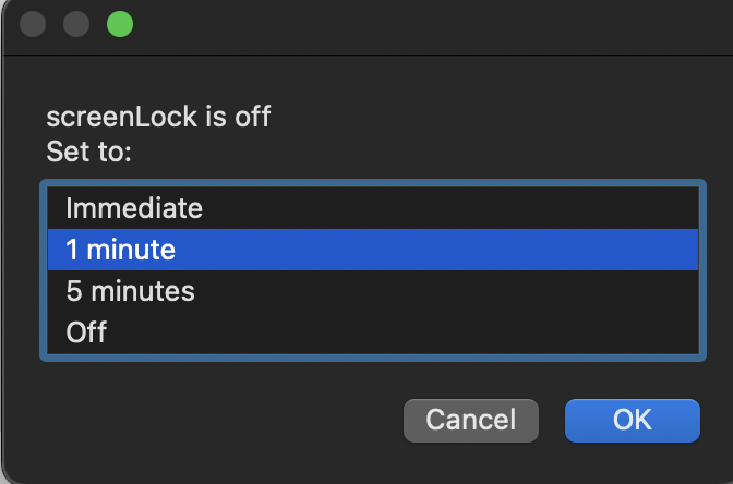

A version with multiple choices:
Code:
set theLockChoices to {"Immediate", "1 minute", "5 minutes", "Off"}
set theLock to choose from list theLockChoices with prompt ScreenLockStatus & return & "Set to:" default items {"1 minute"}
if theLock = {"Immediate"} then
end if
if theLock = {"1 minute"} then
    do shell script "/usr/sbin/sysadminctl -screenLock 60 -password 1234"
end if
if theLock = {"5 minutes"} then
end if
if theLock = {"Off"} then
    do shell script "/usr/sbin/sysadminctl -screenLock off -password 1234"
end if
