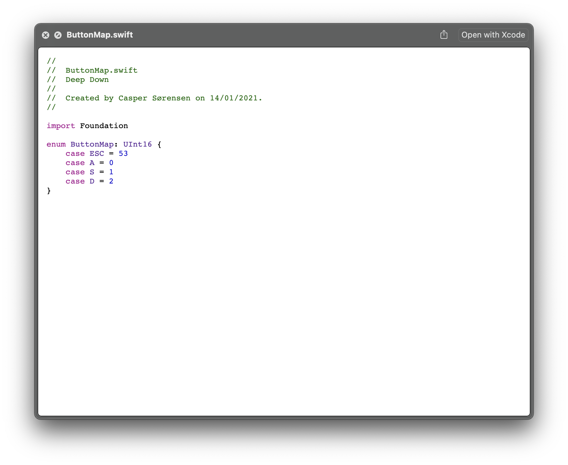

Well, for one of my other SpriteKit projects (very early stages, bigger project) I'm doing this
Adding keys to it as I need them. Then in the switch itself I just do like
Code:
case ButtonMap.ESC: characterSelection.close()
or whatever.

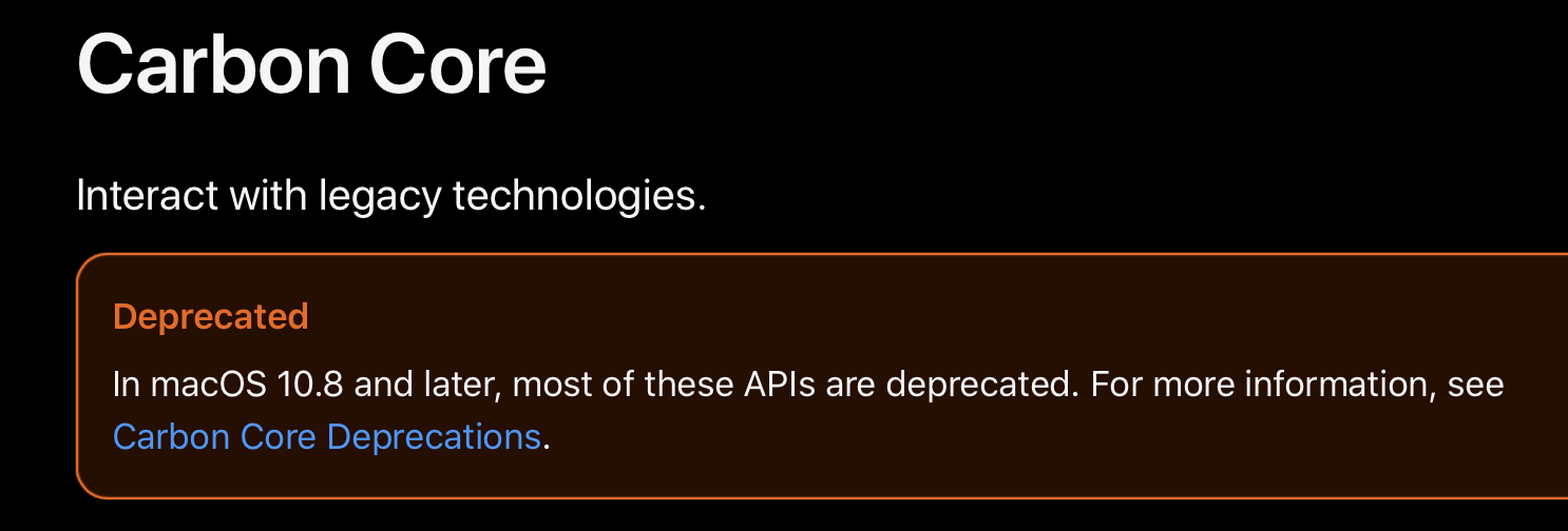

My hesitance with Carbon is that it's considered a legacy, deprecated framework
Though I can't find specific mention of the HIToolbox on developer.apple.com, Carbon as a whole s considered legacy at least. So I'd prefer if a Cocoa/AppKit replacement existed but I know of no key code map like that. Though for most cases one could also use the character options

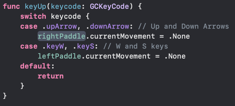

Update! It's not live to git yet, but while experimenting with a PS5 controller I discovered the GameController framework has replacements for the key codes stuff. They have a "GCKeyCode" enum, so it's basically the same thing I had started doing myself for the other project I sent a screenshot off.
(Experimenting with different structuring right now, so it's not using the NSEvent keydown method and keyUp here. Instead it's polling every frame to make the keyboard and controller code paths the same. Though I haven't decided how to do this yet. I'm mostly just playing around to learn the Game Controller framework right now 😛 - But it apparently is designed to work for all game inputs not just controllers, so there is a GCKeyboard so your game input code can all look the same)
