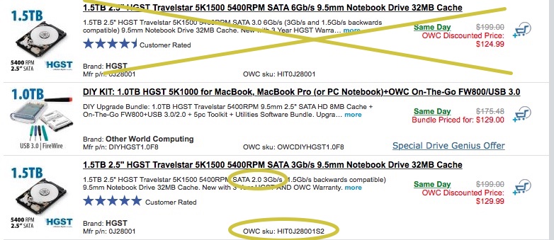

yes, this is the exact one I put in friend's optibay: "equipped with a 3Gb/s SATA interface" (http://eshop.macsales.com/item/HGST/0J28001S2/)
it's this drive http://eshop.macsales.com/item/HGST/0J28001/, but, OWC put a 3G/SATA II interface on it for compatibility with these MPBs, they sell a "data doubler" optibay unit, not sure if you got this or iFixit's unit, but, they both do the same thing.
here's a quote from a review: "the right solution for the 2011 Macbook Pro
May 10, 2014
I tried to install several hard drives (> 1to) in the optical bay of my 2011 Macbook Pro. Only this one is working and it is working perfectly.
I would recommend this to a friend!" (again, this is the one you want: http://eshop.macsales.com/item/HGST/0J28001S2/) OWC SKU: HIT0J28001S2
you can live chat with them to be sure.
(here's their old blog post on it: http://blog.macsales.com/9831-2011-mbp-optical-bay-only-3gbs-no-problem)
May 10, 2014

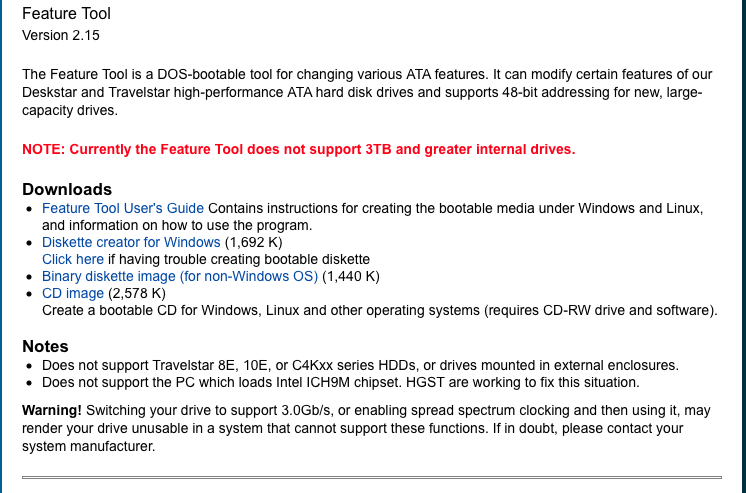

OWC just used the hsgt utility you can get from the support website themselves and repackaged the hdd. Samsung utility is still on wd support site and there's a good chance it will as legacy support isn't limited to just these Mac chassis.
As a spinning disk won't saturate a sata 2 interface anyway I would get the drive and take a punt to see if the utility works though you may need another computer to do the work. Lot cheaper than a deluxe optibay

yeah, that's for Samsung, and from 2009. I was searching HGST's site, since that's the current drive being sold by OWC I was referring to. My friend had just happened to buy the HGST 1.5 TB SATA III drive from OWC, but, he needed the one OWC modded, so had to return it. I had skimmed some reading on this issue, but, my friend ordered things before I got a chance to talk to him about it. So we tried both drives (this one and the SSD he got), neither would work. OWC worked well with the return/exchange, tho, ...they have great customer service. I still think, even if I found the utility, it would likely be dos or win based.
HSGT utility is the the legacy section of downloads iirc
OK, found it, it's DOS: "The Feature Tool is a DOS-bootable tool for changing various ATA features - See more at: http://www.hgst.com/support/downloads/legacy-downloads#sthash.xyZXS6Q7.dpuf"
It says it works with Travelstar, and it's a Travelstar drive. So, that's surely what they use, you got it.
It definitely works with the 1tb 7k1000 I had to downgrade one for an early 2011 with the same SATA handshake issues you have with the larger drive. Booted it off a windows pc not a Mac you will find out if it can work when you hold down option on boot.

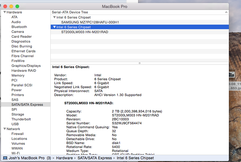

I've been running a Seagate M9T in my early 2011 for four months now and haven't had a single issue. I can confirm that it runs at 6Gbps and is recognized fully.
