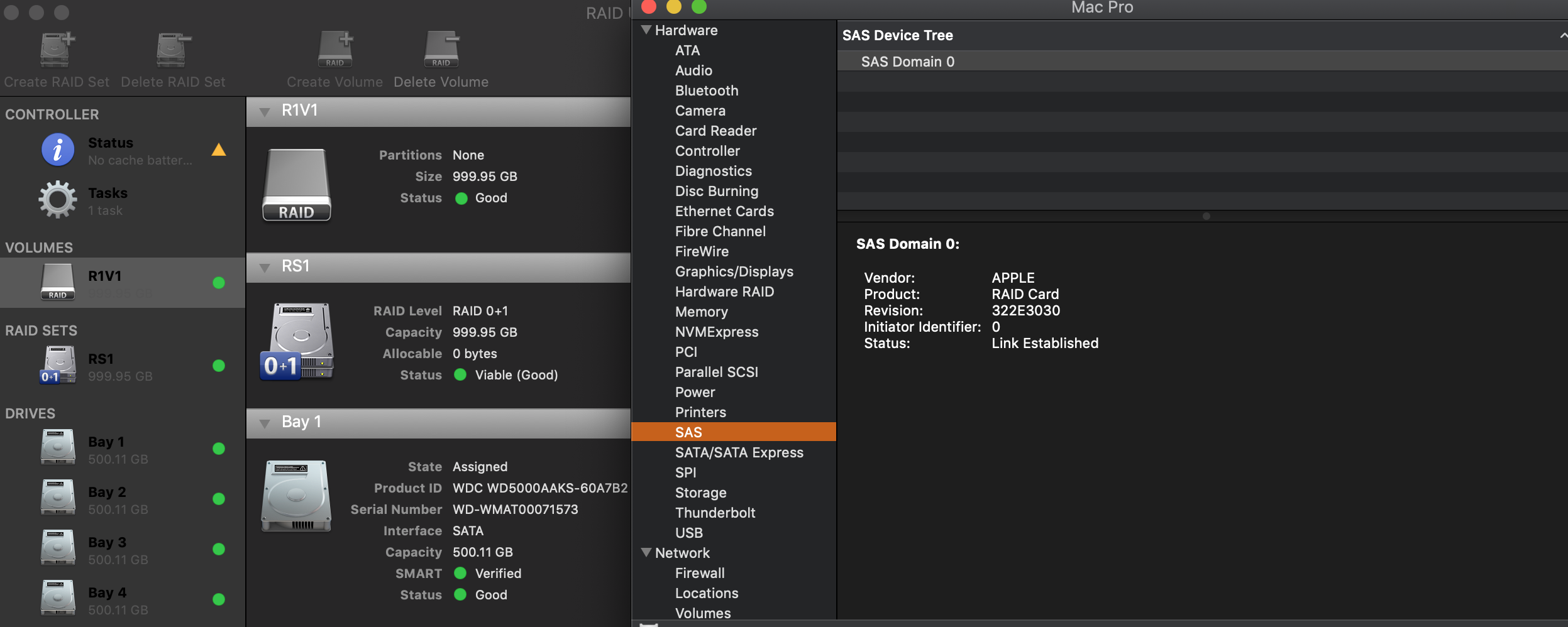

Thought I'd give a warning to anyone considering getting an Apple Raid adapter; I've had mine for about two years, bought it for 20$ on eBay.
Today I discovered that although my Raid Set and Raid Volume still exist, there seems to be no partition on my Raid Set. I'm not sure how this happened, I'm still trying to figure out if I lost any data that isn't recoverable.
SAS domain tree in System Information is empty.
The battery has been 'precharging' for the whole life of the card; I was actually just about to order a LI on eBay without the power controls or whatever on it and solder it in as a replacement.

Data still gone. Wondering if I should keep the drives around and order another raid card or not just to see what happens. Raid card seems to be operational, so I'm not sure if whatever happened happened at that level.

Trying to think of how I would go through some forensics to recover the data, seeing as the drive isn't exposed to me until I create a partition on it.
I think I need to create a blank partition, then scan that to see if any of the files come through.
Any thoughts on a better way to do this?
