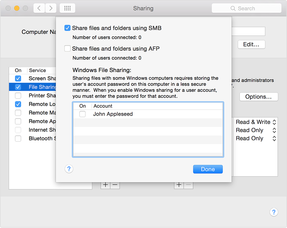

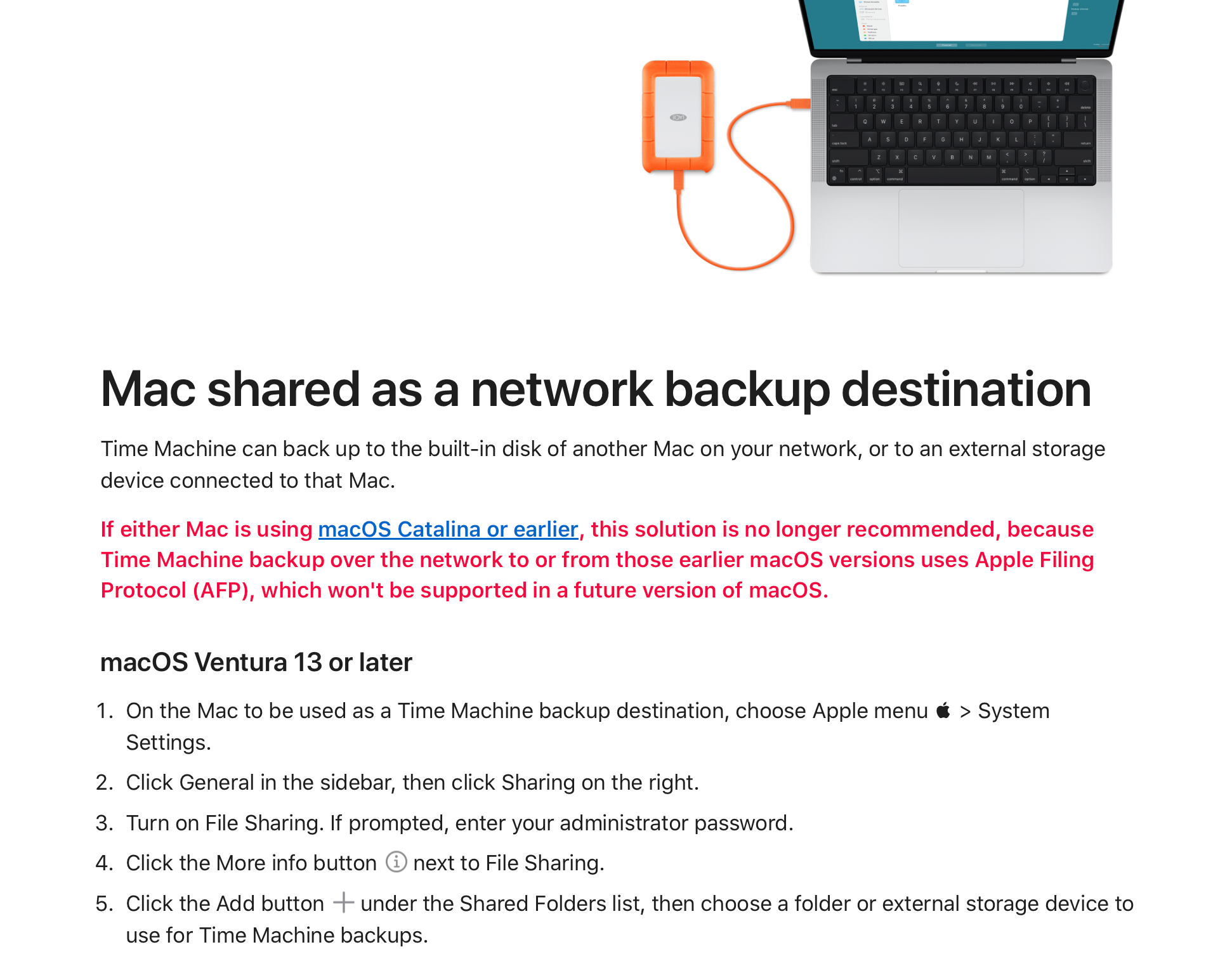

This could also become a problem with »Mac shared as a network backup destination«
if you use an older Mac or can't update further than Catalina (or High Sierra 10.13.6 because you want to keep Server 5.6.3 like me). So maybe better turn SMB on and AFP off (for your backup drive) then.
(https://support.apple.com/en-us/102423)
Reactions: mbosse

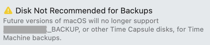

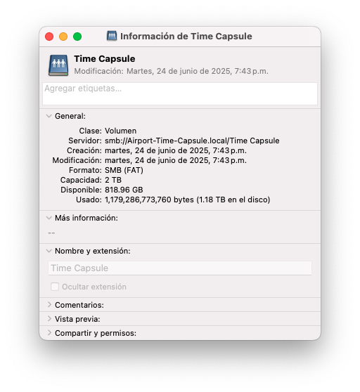

I came here because I just got a notification when the scheduled TM backup started after updating to Sequoia 15.6. It directs me to this webpage (https://support.apple.com/en-us/102423?cid=mc-ols-TimeMachine-article_102423-Settings-04282025) that has a remark under the AEBS and Time Capsule section saying "These solutions are no longer recommended, because they use Apple Filing Protocol (AFP), which won't be supported in a future version of macOS."
PS: Connecting to the host "smb://Airport-Time-Capsule.local/Time\ Capsule" appears to establish the connection over SMB? I'm not sure what SMB version it uses (probably stuck at v1?), but would that work around the problem?
Can you try backing up with that kind of connection?
I don't have extra Macs where I can nonchalantly install Tahoe Beta...
I'd say there is no need to install Tahoe (Beta) to test that. If Time Capsule backups work via SMB connection there is a good chance they still work when AFP is unsupported in macOS.

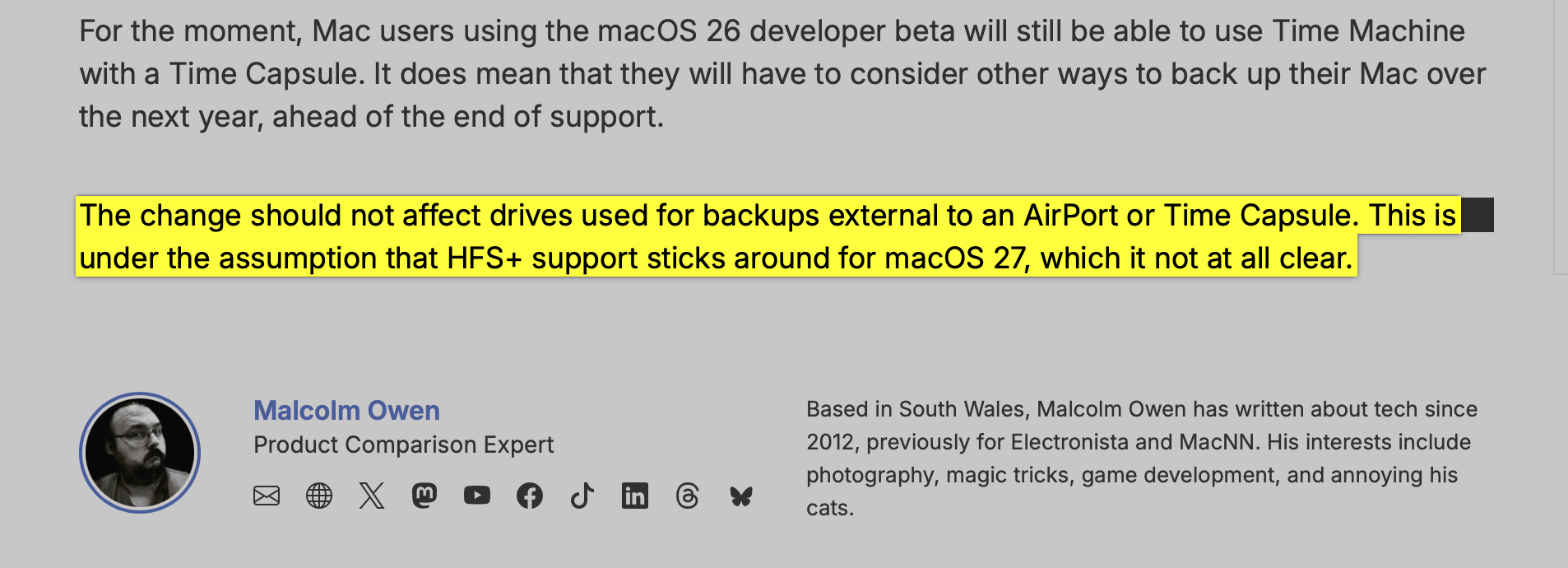

Other than some users here tell us there could be still a chance that external drives connected to Time Capsule could still work with macOS 27.
For some reason apple insider concludes its article with "The change should not affect drives used for backups external to an AirPort or Time Capsule. This is under the assumption that HFS+ support sticks around for macOS 27, which it not at all clear." Probably due to Time Capsule's capability to use SMBv1 instead of AFP. SMBv1 is not yet announced to be abandoned in macOS according to apple insider.
I should state though that I get the Time Machine warnings for such external disks.
Maybe such warnings disappear/are void if connected via SMB.
