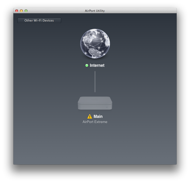

hi having exactly the same problem with mr ed. i couldn't downgrade my airport utility to 6.2. the mac OS dont allow me to install a lower version of airport utility.
Not working for me. 🙁
Didn't work for me either.
