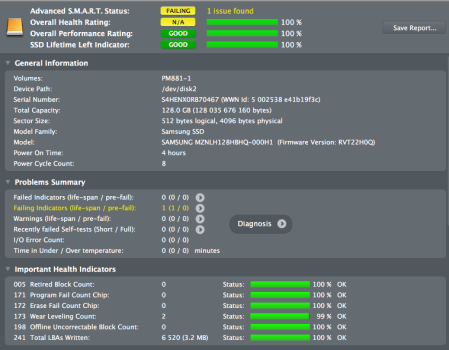

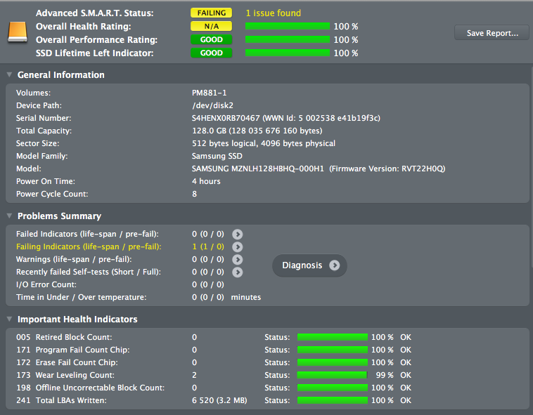

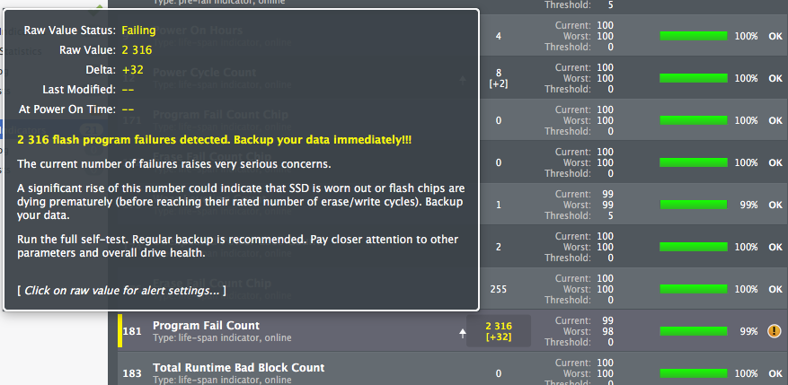

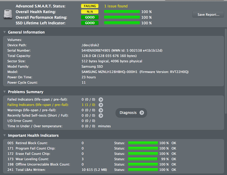

It turns out, that, although they've been apparently used only for a few hours, they already had a large number of 'flash program failures'. At the beginning, the number of defects was in the 2000 range, but after a few more hours of intensive testing, they have risen to more than 200 000 in my case!

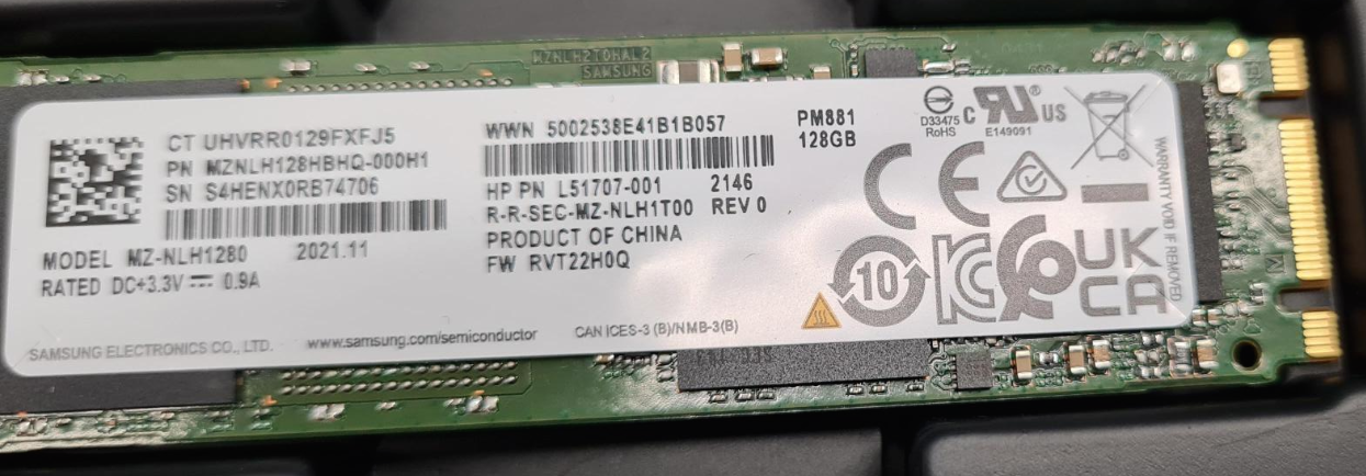

The part number of this batch of PM881 is MZNLH128HBHQ-000H1. Judging by the '000H1' at the end it is OEM drive for HP. This means that the buyer will not be able to return the drive to Samsung and, most probably, there will be no firmware updates from Samsung/HP to fix this problem, which, by the way, looks very similar to what plagued Samsung's 870 EVO drives made in 2021.
