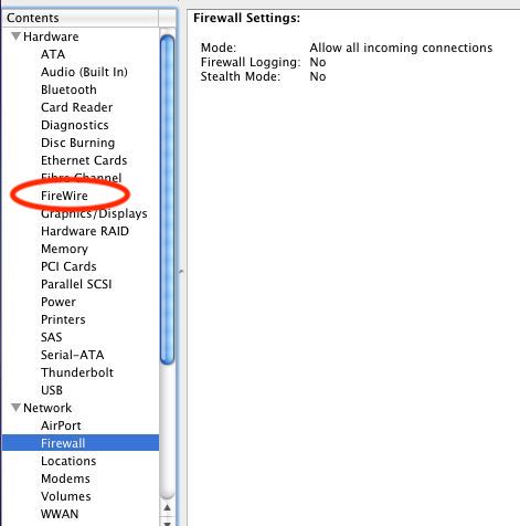

Have no idea how this quit working out of the blue. Tested all ports, front & back. Via OWC external firewire drive, which works when plugged into the USB ports.
Can RomTool fix the problem ?, thanks

I had to ask, since I tried looking up help trying to resolve this issue. Tried everything I could find. Reset NVRAM, unplug overnight, hold button in for 5 seconds, etc.
I know it's not the OWC hardrive, cause it works on my 2010 Mac pro on the firewire ports. So I gather cable and firewire bus okay I would imagine.

I tried something crazy, and started with a fresh install going way back to Leopard, and the same thing (Warning unable to list firewire devices). I kept moving forward and installed Snow Leopard and I be darn it populated
What's up with that ?
Missing files that were only in earlier OS >?
I'll see if it disappears when I update to Lion.

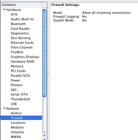

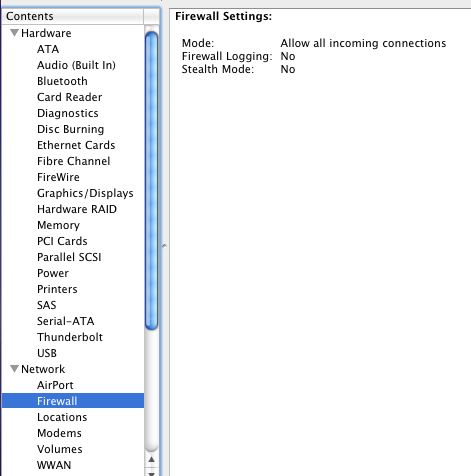

It shows FIREWALL not FIREWIRE in the picture post #6.....
Reactions: Ludacrisvp
Darn I feel stupid LOL.
Got to be the firewire bus fried. Odered a PCI firewire card from eBay, that should work.
