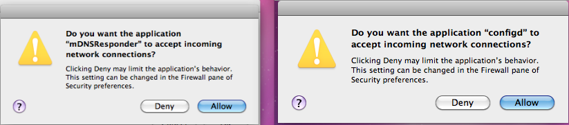

Always thought the memory of computer kept time and wifi network, both of which were forgotten by MBP but on the odd occasion it runs out before shut down, this happens
Have allowed both, no risks involved there I assume?
Just wondered, thanks
Time is kept by a computer's NVRAM. Aside from the main battery, computers have an extra battery meant to last many, many years without needing a charge, and this keeps the NVRAM running, so even if the computer battery dies, the time and date is kept. How old is your Mac? The NVRAM battery may have died, meaning it can only keep time as long as it's running. I'd recommend flushing the NVRAM.
I don't think there's a problem allowing those, no. As long as they've not been replaced by malicious versions, they're Apple software. I'm pretty sure they should be allowed by default though - have you tried repairing permissions?
Judging by the aqua interface, you're on an older OS X version - which is it?
