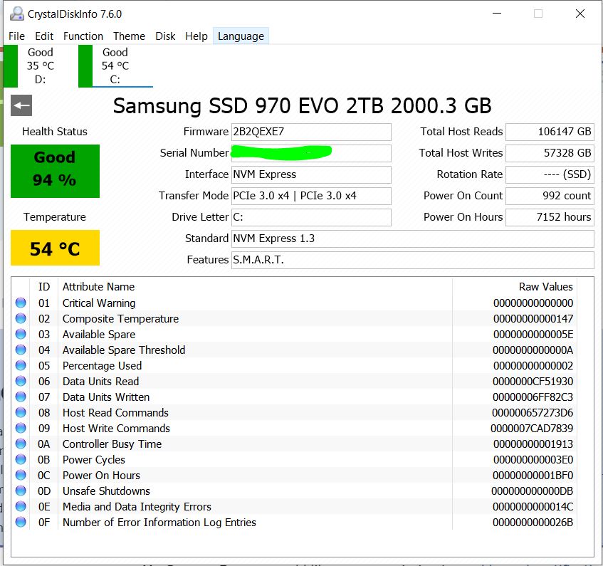

For what it's worth.. the Samsung App says health is 100% so I ignore the 94% that crystal disk info states. Is it possible it has something to do with the chassis they are in? like you stated with, but maybe it's sending a weird reset command that timed with a sudden power cut causes corruption. One thing I noticed in my laptop.. the SSD stays awake 5-10 seconds after my machine is totally powered off. I can tell because it makes a very quiet buzzing sound.
