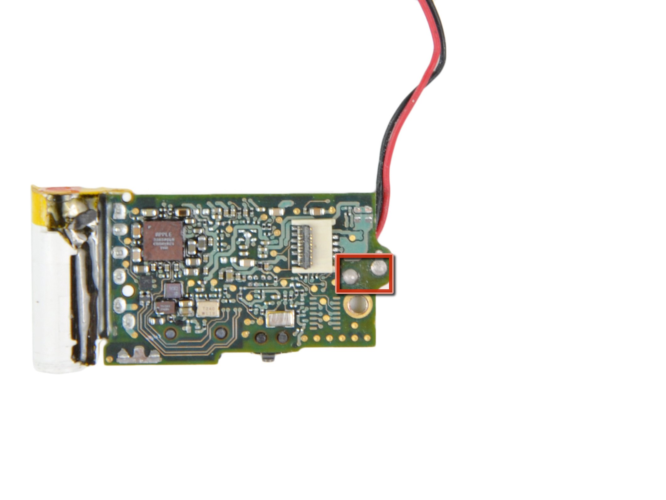

It seems like maybe water got to the control board and killed it. That is a pretty fragile part so it wouldn't take much. If it has intermittent issues otherwise, it's probably the whole board is damaged.
Sadly, the unit might be permanently damaged. If it's doing this even 9 days later, it probably won't correct itself. If you do decide to find another shuffle, they can be had for around $50 on eBay, and the second gen (very similar to 4th) is also available for as low as $20.

Washed my nano 6th gen once and had to replace the battery and the display.
So maybe a battery replacement will do the trick for your shuffle?

I think you're having enough issues with it that indicate board level damage. Unless someone is really good with fixing damaged Shuffle mainboards you'll probably end up with a new mainboard in your old shell.

True, but a damaged battery can cause the faulty behavior as well. It wasn't a big thing with the nano to replace it, so maybe it's worth a try. (If you already have a replacement it's most likely not worth the effort..)

I can imagine that opening a shuffle is quite hard, due to how small the parts are. If OP has the patience to do it, then it might be worth a try

it says 'verry difficult' but I assume that's because of the soldering. It was the same with the Nano and if you have some soldering experience and a steady hand, it's not really a big deal.
