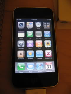

Alright, here's the deal. I have an iPhone 3G that was dropped in water for a few seconds, and I took it apart, cleaned it out, and got it to "work" again. It connected to iTunes and charged the battery, but I was having issues with the screen giving a good image (it was pretty dim and was flickering). As I was working on it, one of the little wires in connector 1 broke off. I wasn't going to give up, so I found the wire and tried to solder it back on (pretty tiny for a solder job, but hey, might as well give it a shot). Once I got it on, i was shaping it and the **** thing popped off and I couldn't find it. I won't have small-gauge wire for a few days so I'm weighing my options before I continue. So here are a few questions...

I appreciate the sarcastic optimism and encouragement regarding my expertise and eagerness to learn. I just wanted to say that I finally got around to messing with the phone the other day. Long story short, I found a microscope and sharp solder tip, resoldered the connection (which was for the backlight), cleaned out all of the parts and scrubbed off as much as I could, reassembled it, and voilà! The digitizer, dock connector, home button, and volume/vibrate buttons were giving me some trouble, but a little more cleaning did the trick. It's rigged to not register as an iPhone with AT&T and all of the parts function properly.
