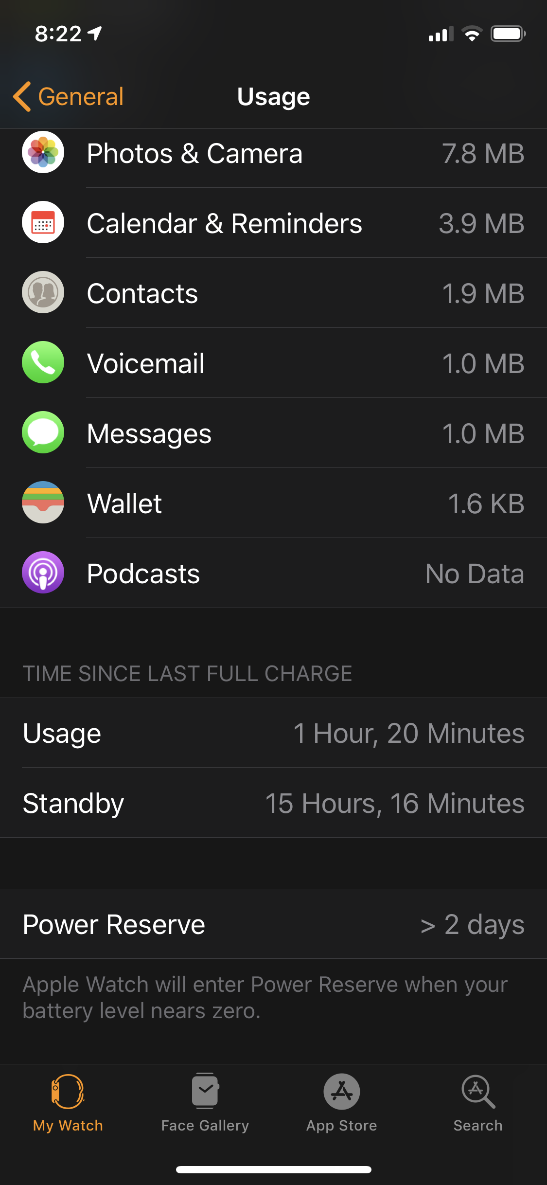

Just to update my experience a week further on.
I have adopted a new routine.
I wear the watch at night.
I charge it up to 100% every morning. Not exactly same time each day.
I have all the third party watch apps I want installed on watch and phone and use them fully. (AutoSleep, Hearing Aid app, Heartwatch, Dark Sky).
I have been recording:-
1.The % charge remaining, just before putting in on charge
2.Usage/standby times just before putting it on charge
From these two it easy to calculate the %drop/hr
The last eight days:
1. 59% 2h46m/26h0m 1.6%/hr
2. 70% 2h25m/29h41m 1.5%/hr
3. 80% 1h20m/18h07m 1.1%/hr
4. 56% 6h17m/20h29m 2.2%/hr
5. 28% 17h19m/21h57m 3.3%/hr
6. 40% 14h12m/21h41m 2.8%/hr
7. 67% 2h16m/22h37m 1.5%/hr
8. 63% 2h56m/22h15m 1.7%/hr
Comments:
1. I can't identify any reason for the variability, eg workouts on somedays etc
2. The high %drop days are always due to high usage time that day.
3. I did not restart the watch at all. I have previously noticed that restarting the watch returns the watch to a normal 2-3 hrs usage per day. When I saw the high usage and big drop on day 3, I thought I might have to restart it, but I didn't and it recovered back down to 2-3hrs by itself.
4. It looks like the process causing the high usage started during day 4 and stopped during day 6.
I have been monitoring this much more than I ever did with the series 3 watch, so can't make exact comparison. In particular I cant say whether it had the same variability, but I think not.
I am OK with daily charging in the morning. Some days it would probably do a whole second day but I think routine is good to avoid surprises.
