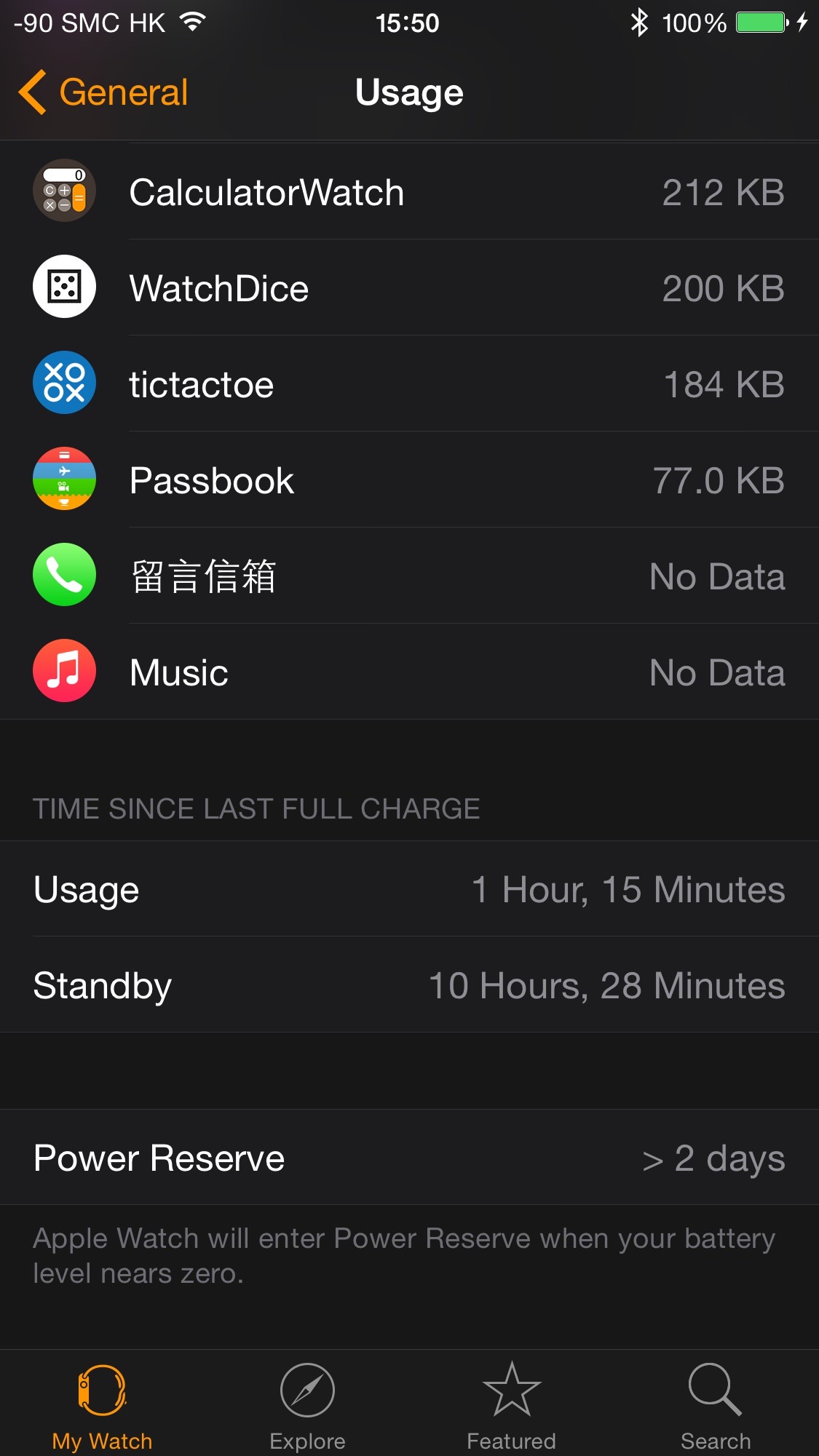

I fully charge my watch, and then wear it to sleep last night. This morning, I use the watch to check all the notification and email etc, and then make the following screen capture.
As you can see, the watch use around 2% of battery per hour. So, IMO, only 7% for 6+ hours in your case is actually very reasonable.
Also, I am pretty sure my actual usage is less than 1:15. I don't know how it counts, may be some background activity also count as usage.
