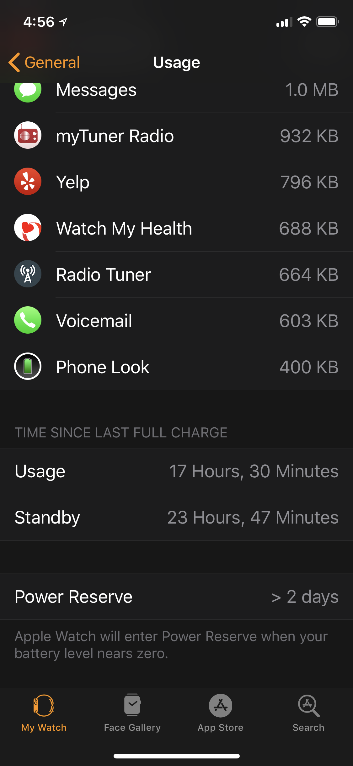

Probably related to my battery drain problem I'm noticing very high usage numbers. Since I'm not using it as much as indicated, any idea what that is all about?
I chatted with Apple Support today. They ran diagnostics on my watch and saw no problems with anything, including the battery.
As a test I wanted to see when the watch would die. It took about 12.5 hours until it shut off. That seems really very bad to me.
