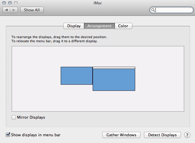

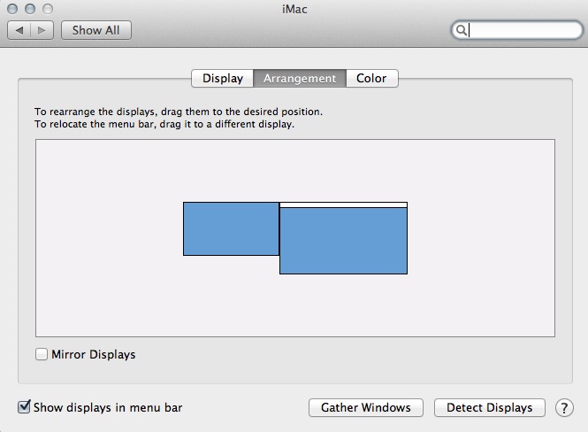

My display setting is like this:
My iMac is on the right and my HDTV is on the upper part of the left.
Keep all your stuff on your Mac side, as normal. When you want to watch a movie, just move the window over to the HDTV with your mouse and push it to fullscreen and you should be fine. Literally drag it as if it was just one big monitor and you were moving it to the side.
In VLC player, you can actually set it to always just play in full screen on your HDTV until told otherwise. You can also have it black out your main screen so you don't have another bright light source when you want to just watch a movie.
Last but not least, you kind of lose a hot corner. So choose the one you use less, and position the second screen close to that corner. For instance, I never use the upper left corner as a hot corner as I would probably hit it too many times while trying to select something from the menu bar. So I positioned it to the upper left (instead of the lower left).
