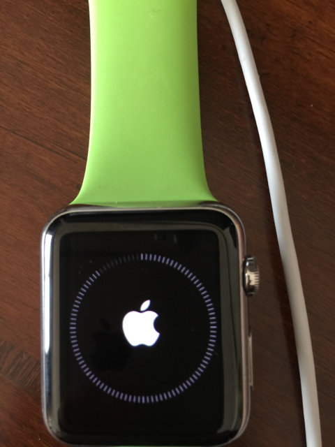

2.2 has bricked my watch. The update stuck at about 90% completion then sat there overnight. The app on my phone says the watch is up to date.
I can't unpair or reset.
Tried to reset the watch manually from the watch itself. It just reboots, asks for my passcode, then starts some sort of update, stopping at the same point.
I can't seem to do a hard reset from the watch itself. Great.
For me, holding the crown gave the option to cancel and restore the Watch when it was essentially stuck. Might be worth a shot?
