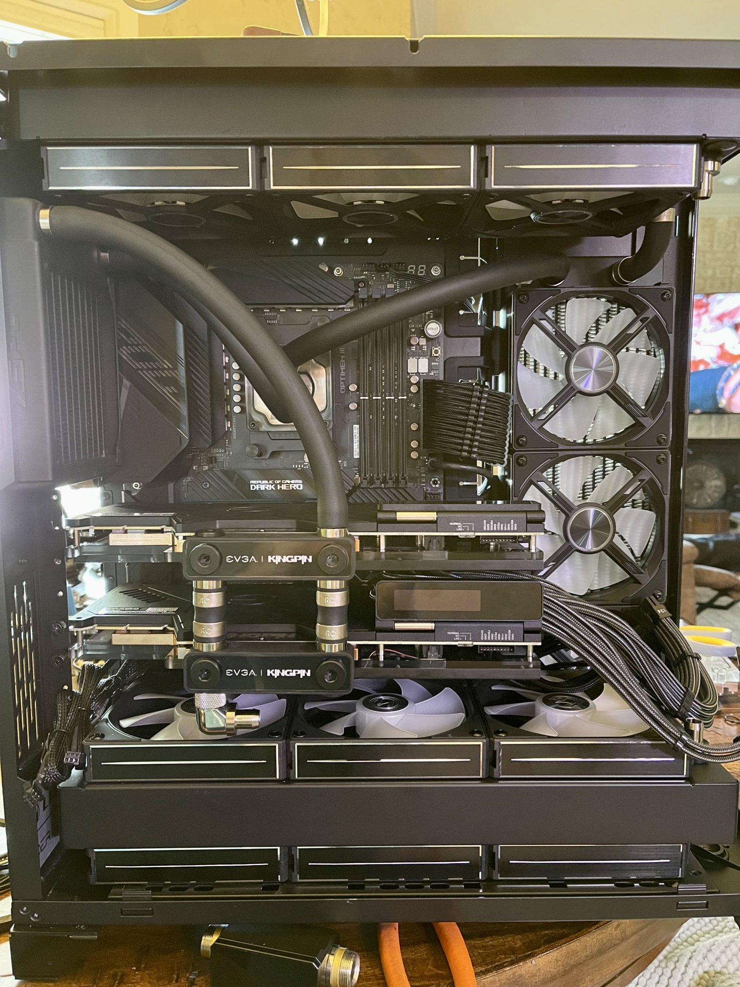

Sometimes this thing draws 800W. I had an AIO, and ended up going custom due to excess noise. Even with 2x360 Rads I am now adding an external 420 (140mmx3) radiator with quick disconnects. Temps in this still get warm, mainly due to ambient, but I want it quieter when working, and currently on a mildly warm day here for sunny SoCal, water temps stay at 40ºC with fans at 100%, at night will go down to 35-37ºC.
I typically let it mine ETH 24x7 except when doing video work which so far has paid for the card and waterblock, which is part of the reason for the heat and noise.
For me, quiet is VERY important. I do love running multiple VMs so family members THINK they have their own computers, plus some dockers for WebODM and retroarch to the living room TV. Really amazing as to the power one can buy now for *relatively cheap.

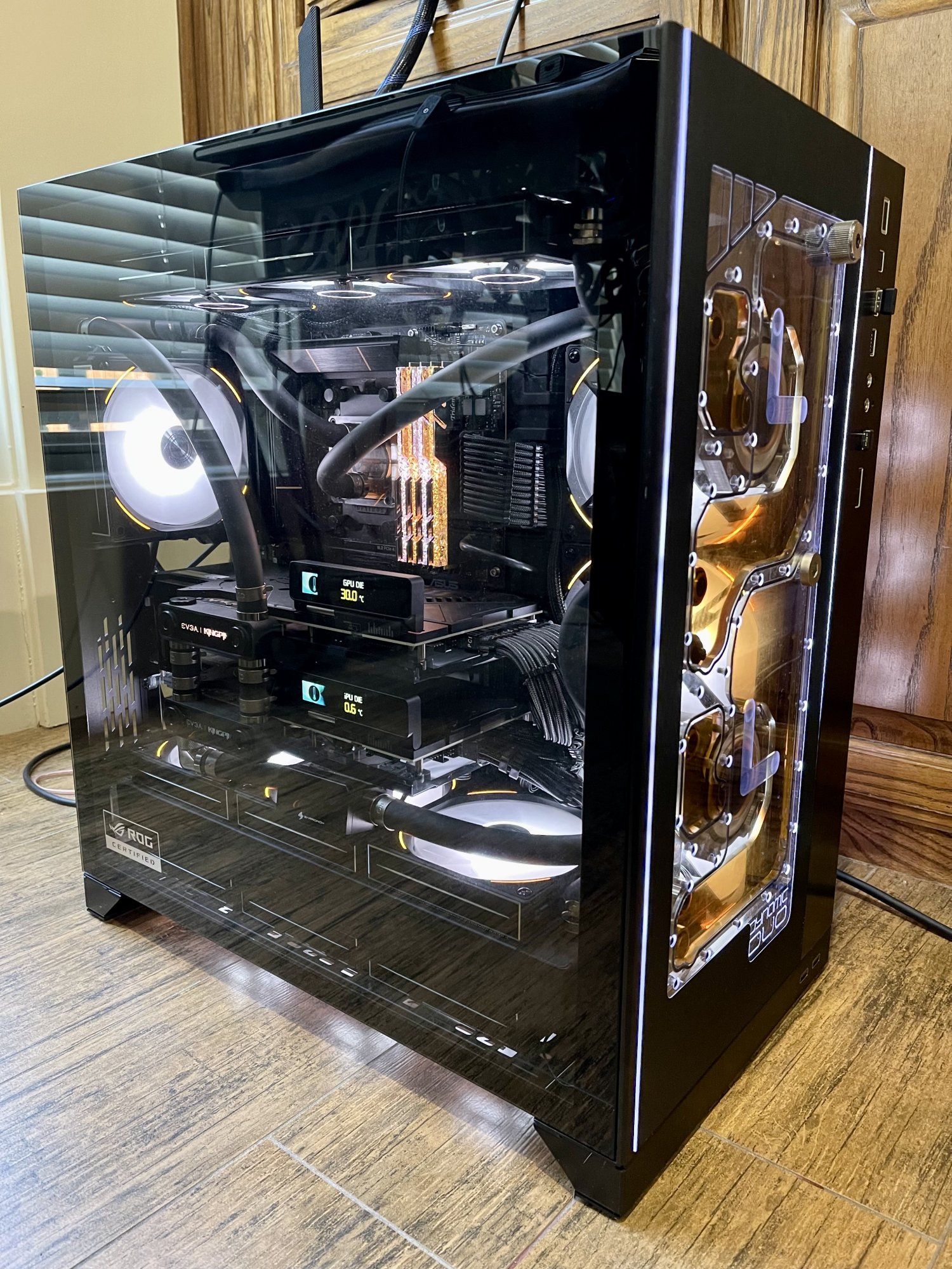

Here is the current build, been putting this together for a year now. Almost finished. GPU waterblocks are the last pieces of the puzzle, hoping a couple weeks on those.
011Dynamic XL, Custom dual D5 pump distrobution plate, 3 - 360mm rads and a 120mm, 16 - Lian Li Uni-AL fans, EVGA 1300 PSU, Ryzen 5950X w/ der8aur CPU bracket, ASUS Dark Hero, Optimus CPU block, Optimus barb fittings and clamps, EKWB Zero Maintenance tubes, GSkill Royal 3600C14 RAM, 2 - EVGA Kingpin 3090, 2TB 980Pro, 2TB Auros gen4 nvme, remote control power on/reset keyfob :) .
Idle temps are high 20's to low 30's on the CPU and mid to low 20's on both GPU's.
Full beans mining w/ both GPU's @ 100% over 24hrs and fans around 1250rpm temps are low to mid 40's, currently 45C.
The PSU 'could' be under-powered, the GPU's have 3 different bios. 1 - 480w, 2 - 520w, 3 - 1000w each.
The GPU waterblocks I am waiting on are from Optimus and have front and rear active cooling and power delivery cooling so they are going to be some THICK waterblocks.
How well does the EVGA Kingpin 3090s cool the VRAM? I would assume not well enough if you are already replacing the Kingpin blocks. The EKWB hybrid block actually works very well considering but my active backplate today to take care of the same problem.

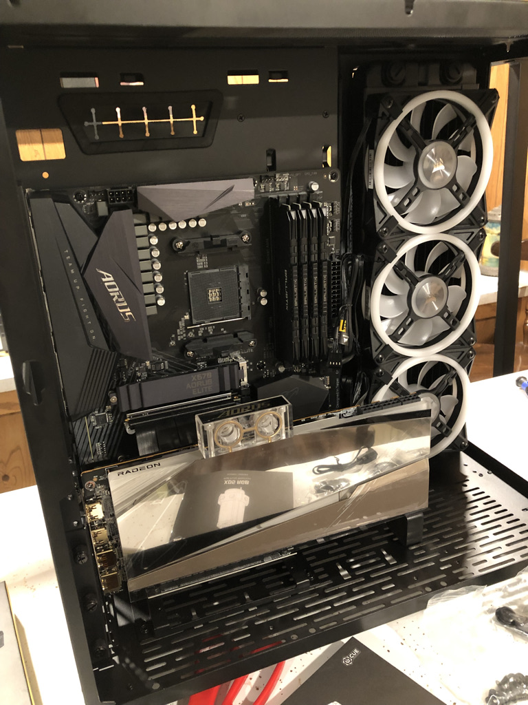

Work in progress as I ruined several tubes in my first attempts and had to order more.
Lian Li Dynamic
AMD 5800x
Gigabyte Aorus Elite
Gigabyte Aorus Waterforce 6900xt (yes, I sent the 3080TI back)
Corsair h305i cooling kit
Corsair RM850x
Crucial 4x8 3600
The RGB is an f'ing rats nest!

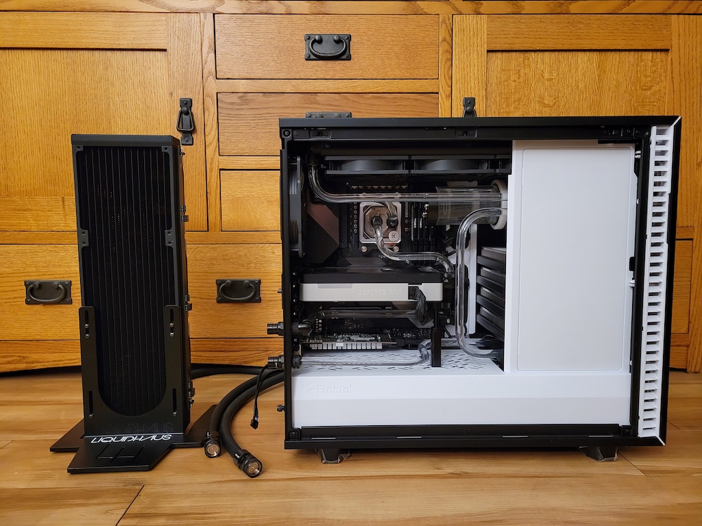

I use air cooler in home server, but my gaming rigs have water. Radiator provides massive heat exchange area with air while maintaining high temperature gradient. dT and dA rule. My main rig pulls 800W+ in spikes from the wall and I can’t hear it.
