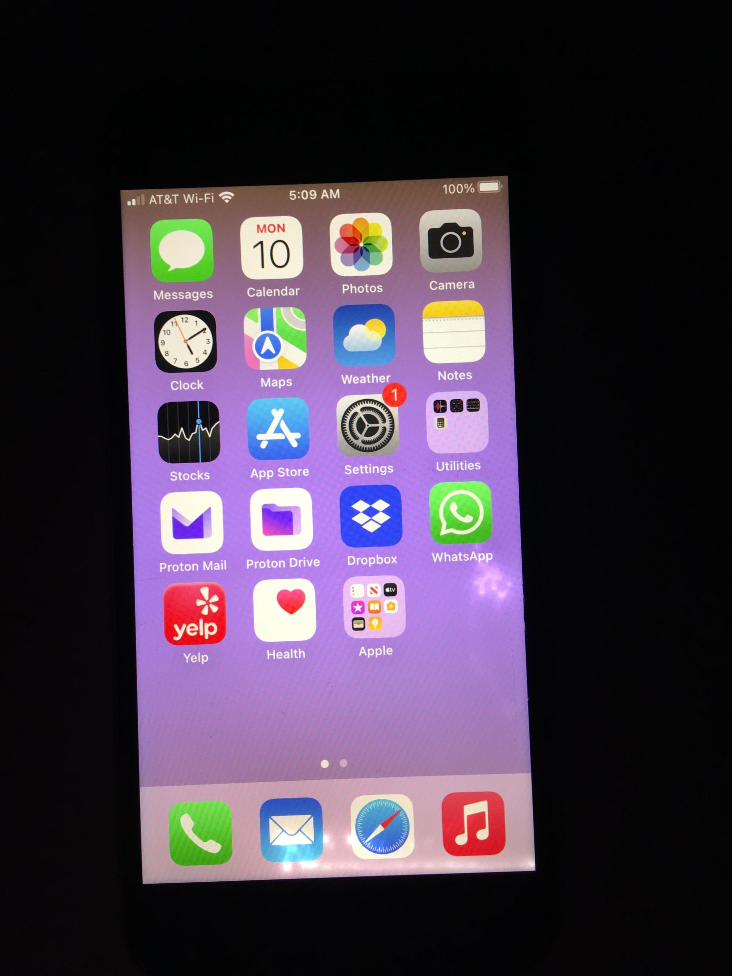

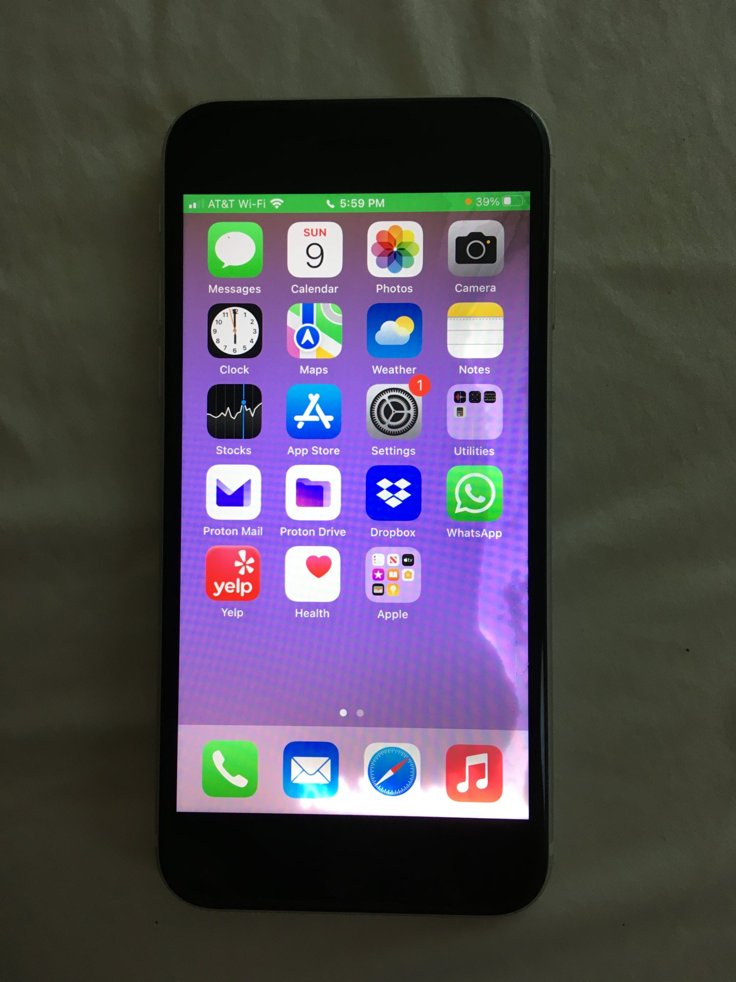

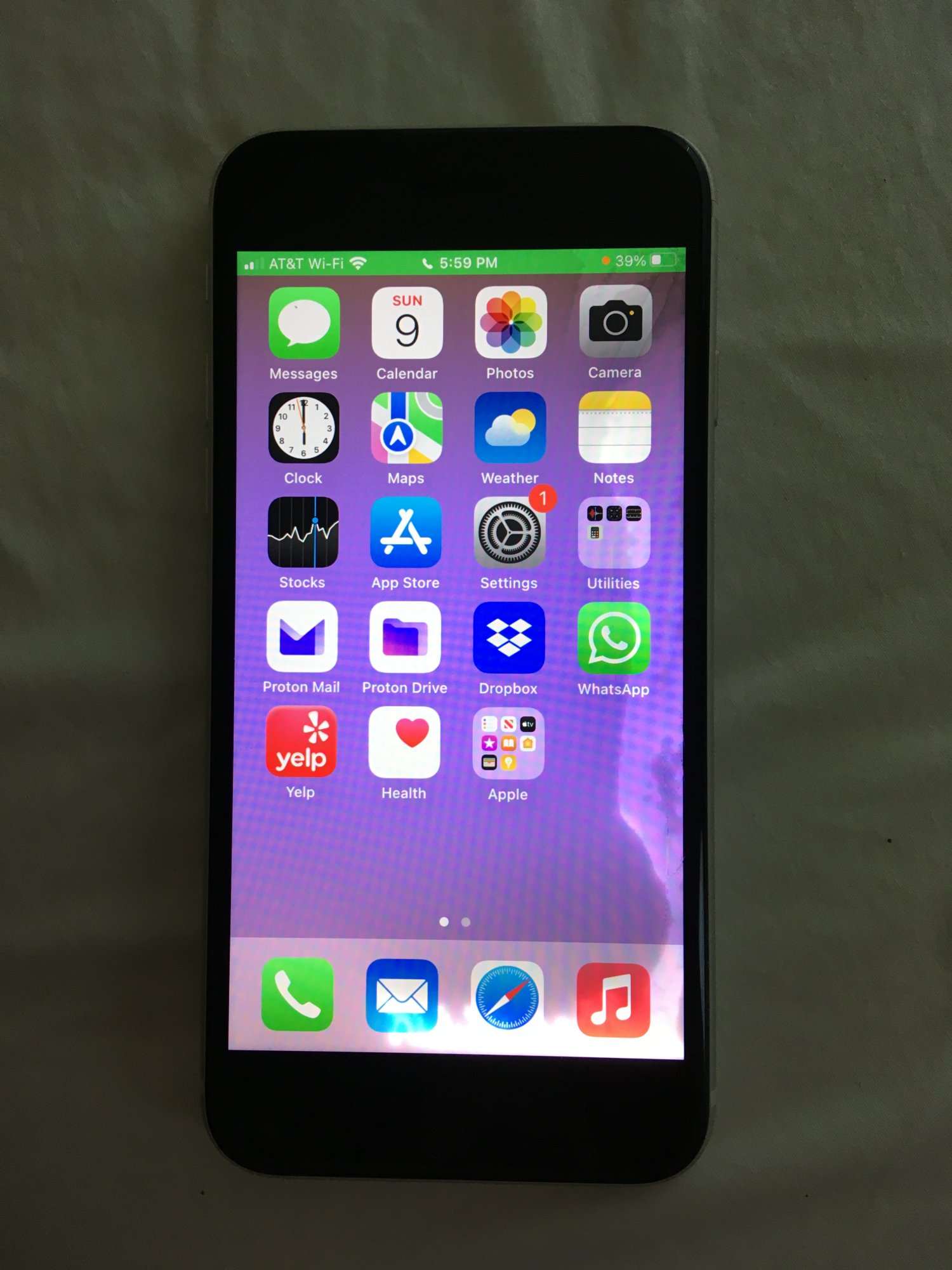

I accidentally put my iPhone in the washing machine along with a blanket. A few minutes in the wash I heard a clunking noise and stopped the machine. I thought it was going to be my car key but it was my phone. It was working fine. But now several hours later I notice what appears to be condensation in the display (see attached, damage is on right side and bottom). A few questions:
- Will this clear up?
- If not, would it be covered under original phone warranty?
- If not, is the phone going to be worth anything if I decide to trade it?

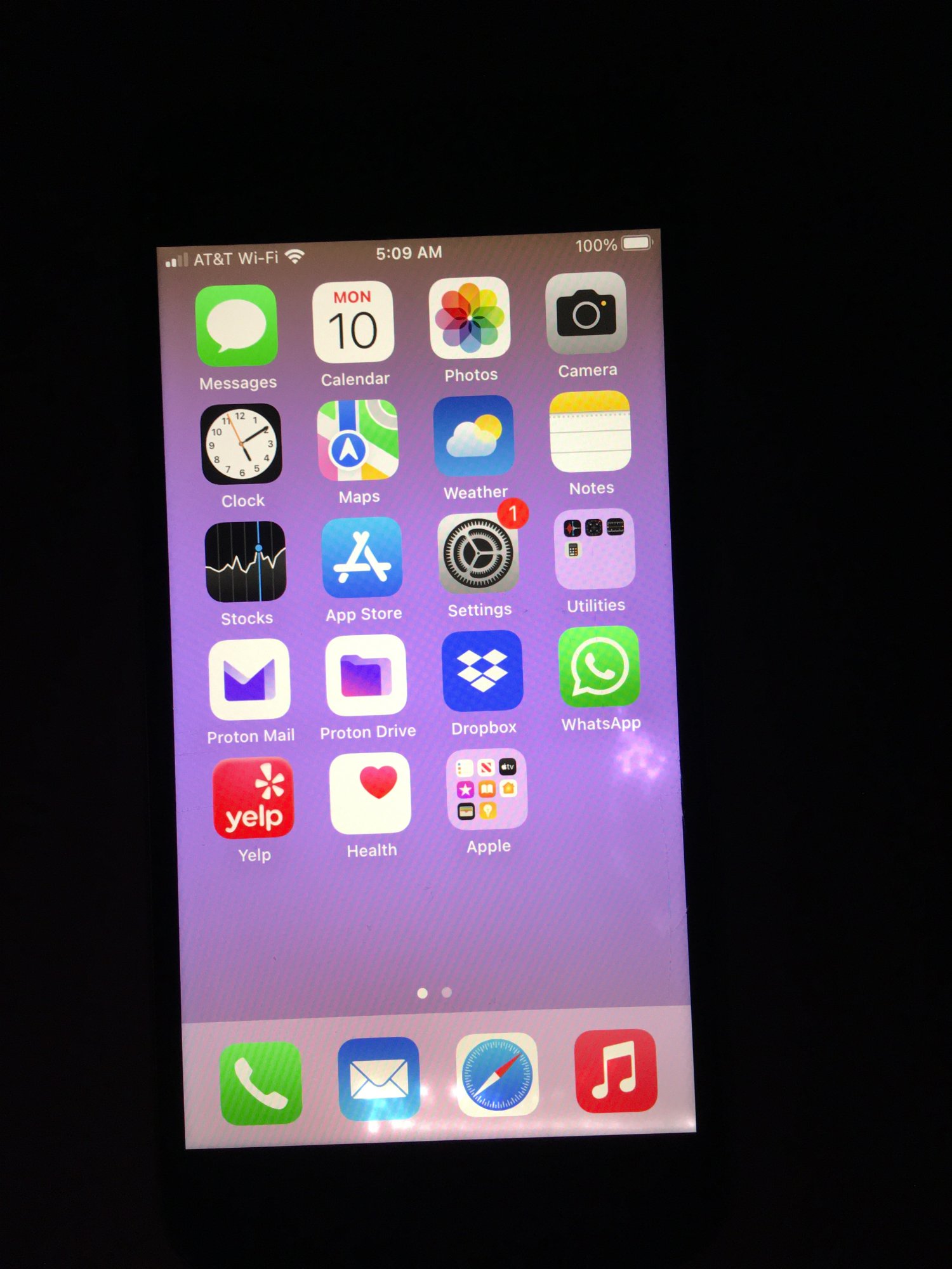

The right side has cleared up completely. The bottom is still showing some marks, not sure that's improved much over the second picture. Will wait till tomorrow, if no improvement, will probably replace the phone.

The damage at the bottom doesn’t look like it’s getting any better. I stopped by the local Apple Store and they said the only service they offer for water damaged phone is full device replacement. For an SE, regardless of storage, this is $99 with AC and $399 without. Mine is 128GB unlocked. So basically a savings of $80+tax over the $479 full price. Not sure if service is taxed in CA but if not I would save on tax on the $399 as well. The main difference between that and buying a new one is I don’t get a box and cable. They didn’t have any appt today for walk-in so I made an appt for the weekend.
