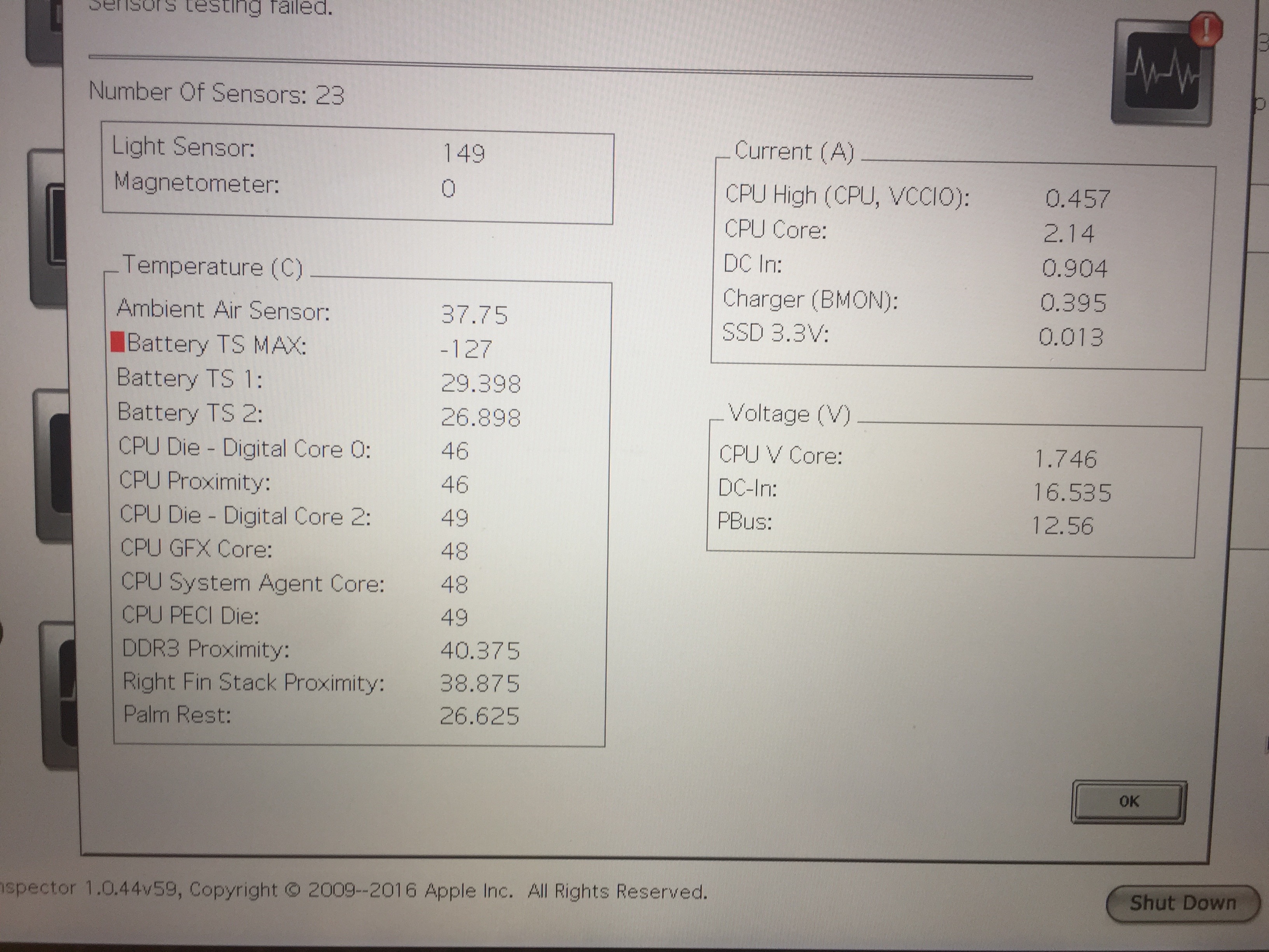

My water bottle broke in my bag and caused water damage to my mid-2014 Macbook Pro with Retina Display

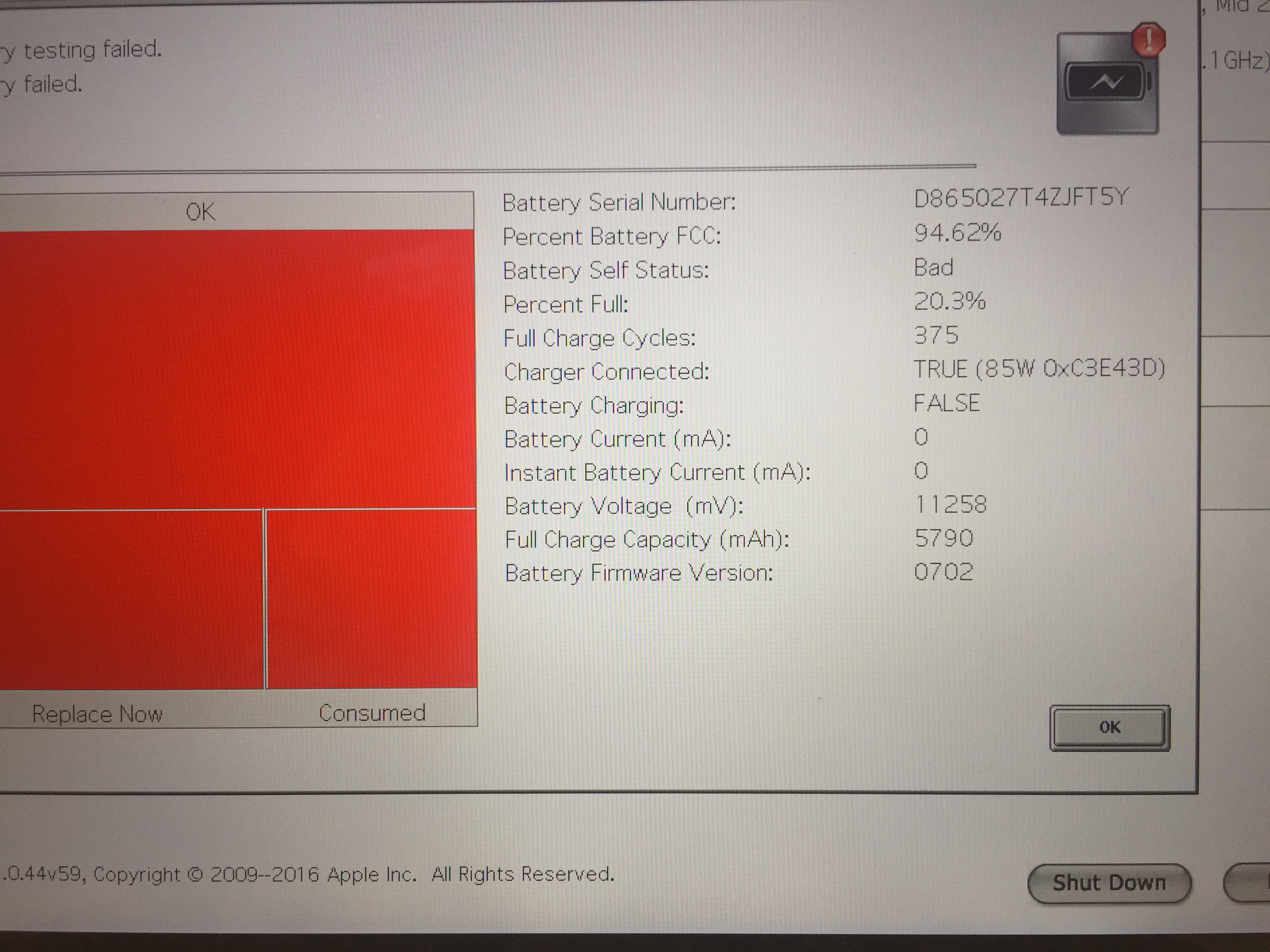

After drying out it seems to be pretty much fully functioning. However, it does not power on unless it's connected to power. I ran a hardware diagnostic and it seems like my battery and battery sensor are out (photos of results below). My question is if I just get a replacement battery will it fix the sensor as well?

If it is a simple as unplugging the battery and plugging it back in, that would be great. If the battery is the only permanently damaged component, then that is good news because you might only need to replace the battery as the worst case scenario. In the long term, other things may eventually go bad because components may corrode... depends on what the liquid was, how much got in, and what it contacted.
