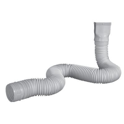

2. Get downspout extensions (and screws to attach). Move the end away from the house where the water won't flow back toward the house.

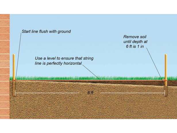

- Slope the yard
