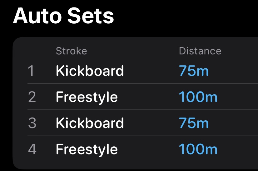

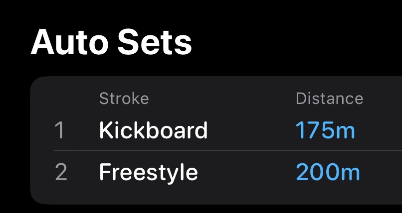

I did finally try some very short combination laps in a 25m pool
100m kick/100mm freestyle (2)
200m kick/200mm freestyle
I do the kick on my back with kick fins (no board but no arm movement either), roll before the wall, flip turn at the wall, come out either kicking again on my back, or freestyle
Seems to miss one 25m length of kick pretty consistently, but always gets the freestyle right. I’m actually happy it’s recording combination laps like this at all. Figure that they will get this new algorithm tweaked over time.

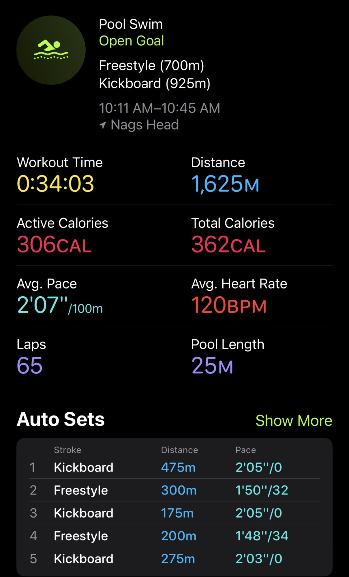

So I did another kick/freestyle combo workout (a bit over a mile) and as before it lopped off exactly 25m of each kick portion of the swim, so hoping Apple spots this and tweaks the algorithm. Still very happy with result considering it never recorded any kick routine before.
I guess the 32 and 34 are my “swolf” scores(?), but not positive about that. They seem decent but I’m cheating with kick fins
