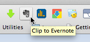

You could also use the fantastic app called Evernote and use the Evernote Web Clipper to capture pages into the app where you can search it and sync it to all of your computers and mobile devices, if so desired.

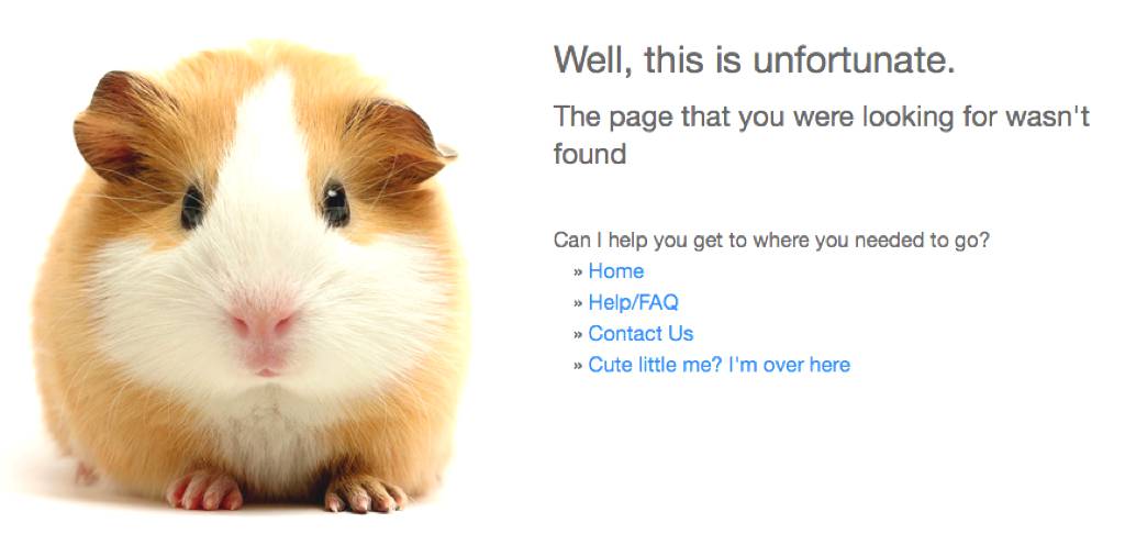

An example of the problem is if I log into my Bigstock account and am browsing thumbnails. If I clip the page, I get the "hamster". In this case, it looks not bad if I print to PDF, but doesn't work in all cases. I could live with this if I could somehow configure a shortcut key to do it.

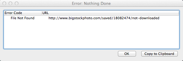

I'm not sure if you read my question properly, but I'm not having a problem capturing web pages to PDF. I just can't capture password protected sites (sites where you have to login to your account to browse). The Capture to PDF feature has been in Acrobat since version 9. I currently have Acrobat X Pro, and I just tried it now out of curiosity. However, it does NOT work in this situation. It's using the exact same approach mentioned by onekerato in the message above, whereby it makes it's own connection to the URL to capture the page.
This does not work, as it does not know your user ID and password to the site, and does not know you are already logged in, so it just says the page is not found. The error below is a screen capture of exactly what I got when I just tried it in Acrobat (using a link that is valid and displayed in my browser). Does it somehow work differently/better in the CC version?

I would have agreed with you, but recently tried the "Clip to Evernote" plugin mentioned earlier, and it DOES handle this correctly, even on password protected sites. It works perfectly... it's just brutally slow. I'm trying to figure out how to get it to clip straight to the native app instead of the cloud. It's formatting is much more precise (and pleasing) than the Print to PDF option, and seems to work in every situation.
That's one cute hamster!
