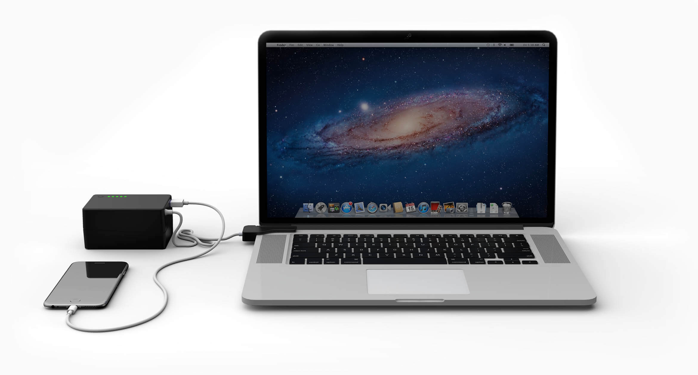

As a follow up to my post above I did some research on external battery packs and the Anker PowerCore+ 20100 states that it works with retina macbook
http://www.ianker.com/product/A1371011
The Battery Box and the Mini both charge the Macbook - I confirmed with their customer service by email
https://www.getbatterybox.com/
Neither of these have pass through charging so don't suit my needs.

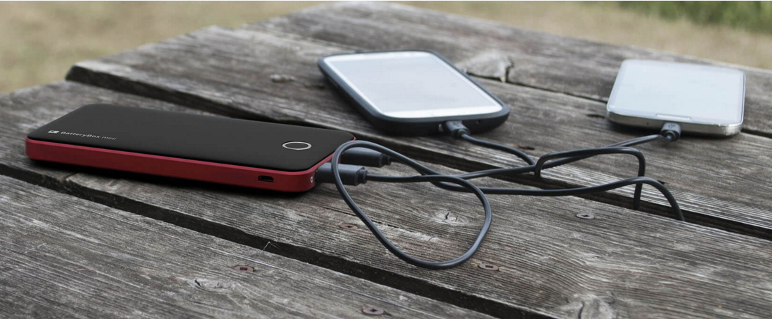

I know that Limefuel ones have pass through charging but does anyone know if these 150X or 200X products are powerful enough to charge the macbook? It says 5V/4.2A max output, which is less than the Anker and Battery Box listed above
http://www.limefuel.com/pages/product-blast
I know Limefuel are bringing out a charger specifically for charging the Macbook but it's not out yet and it's expensive and massive
http://www.prnewswire.com/news-rele...ype-c-portable-battery-charger-300050520.html
Massive being the operative word...
Not my first choice for the Retina MacBook, absolutely not flight friendly. I would go with the Anker PowerCore+
