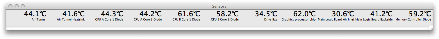

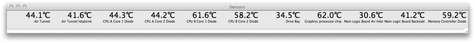

I used Hardware Monitor.app to view the temperatures. Room temperature is about 24°C.

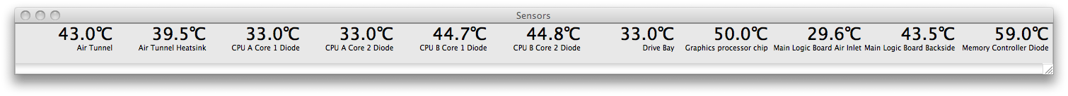

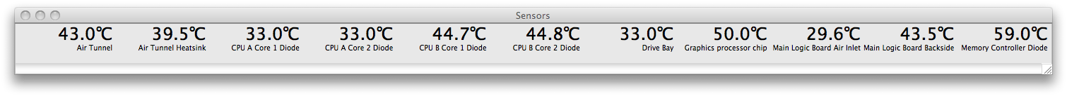

20 minutes later (mostly idling and RSS Visualizer screen saver):
