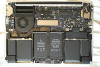

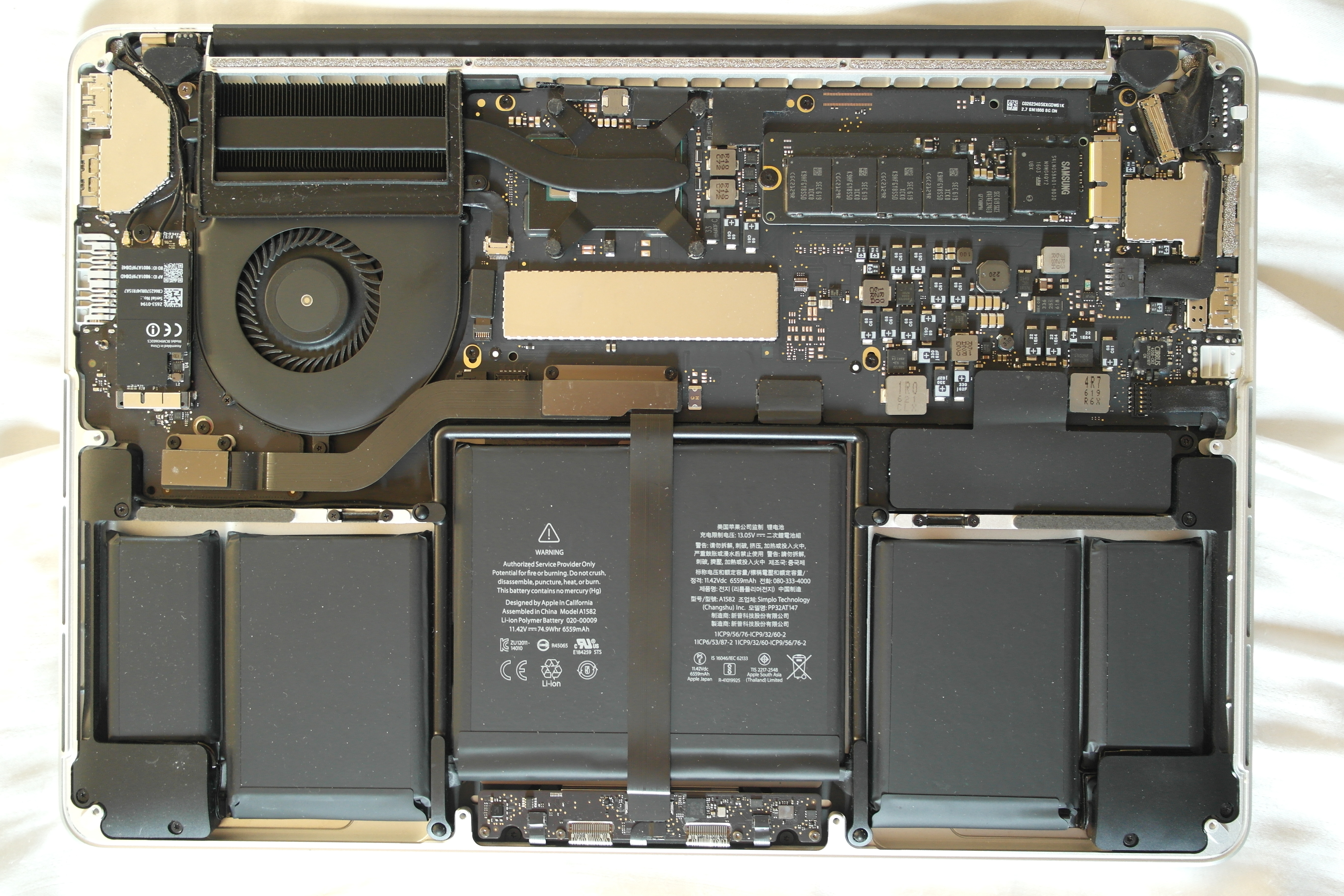

Open up the case and take a look at the battery to see if it looks like an OEM part. For the commenter who said maybe they replaced the battery which includes the top shell and battery, that is not relevant to the 2015 model.
Reactions: Stux
This is what the battery looks like (attached). Could it be aftermarket?
Looks like a legit battery. Since your model has the ability to run diagnostics remotely, I would call Apple support and ask them to run diagnostics on your machine. Only takes a few minutes. Also ask them to run the power adapter test.
