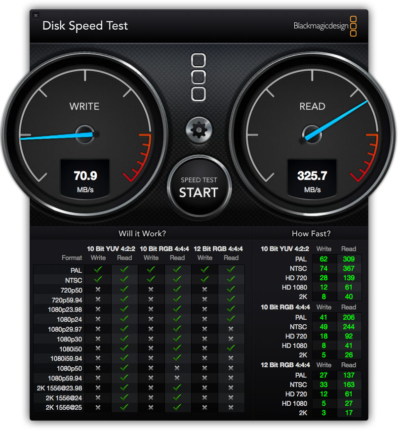

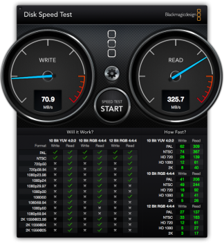

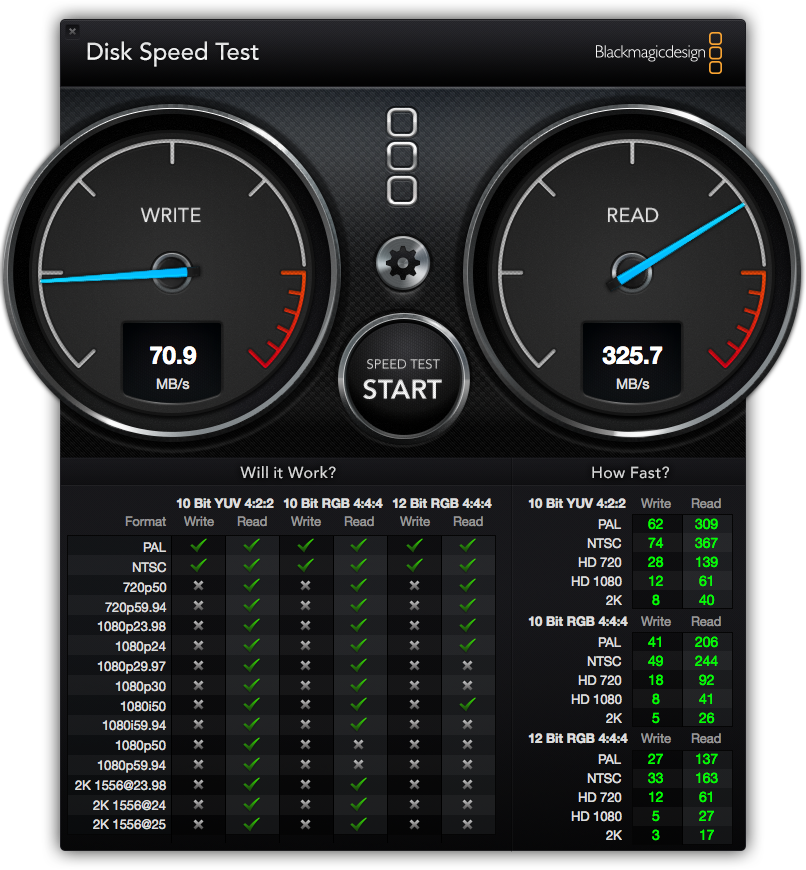

So, the WD Black2 Dual Drive alone isn't going to get you a great result. What I've decided to do, instead, is do away with my optical drive and throw in a 500GB Samsung Evo 850 SSD drive. Here are the benchmark tests after that.
Now, I will also advise that you ONLY use the OWC Data Doubler caddy. I had tried some of the generic ones and they were always crappy, causing some CRC Errors and preventing me from restoring, because the wiring is so ******. The OWC Data Doubler works perfectly and I wish I'd have spent the money on this one the first time around. Don't listen to the stupidity on other threads saying "the generic ones work just as well, for much cheaper." You get what you pay for and if you're buying the generic $12-20 caddy, you'll definitely regret it (especially if you use the new space in a Fusion drive CoreStorage setup).
