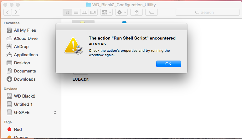

I purchased a WD Black Dual Drive for my Macbook Pro 5,1 and installed it, being sure to follow all of the instructions provided by WD for install on a Mac. I want to set it up to run as a Fusion drive and WD provides two configuration scripts (one for Fusion setup and one for HDD/SSD setup). Problem is that when I ran the script for the Fusion config it thru an error which read "The action "Run Shell Script" encountered an error. Check the action's properties and try running the workflow again" (also see attached screenshot).

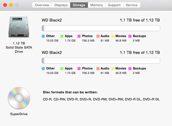

  • If I run "About This Mac...' the storage tab displays the single disk icon for the WD drive (1.12 TB SSD), but then shows two 1.12 TB volumes which are both identical (see attached screenshot).

Check console.app for errors related to the drive setup script that you ran. Look for the timestamp that's close to when you attempted the setup. There's most likely one or more hints towards what the problem really is around there somewhere.
Yeah, don't worry. It's just because the computer knows that there are two drives, but the tool we used from WD tells the computer that they're both SSD. It's kind of annoying, because I'd actually like the computer to know that the 1TB is a HDD, but whatever. I've setup 3 drives together in CoreStorage and they haven't given me trouble thus far.
