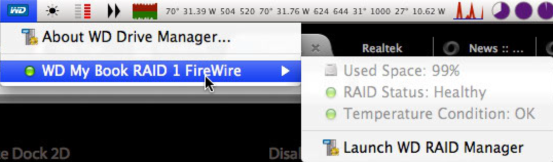

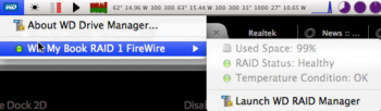

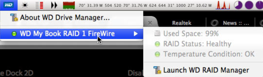

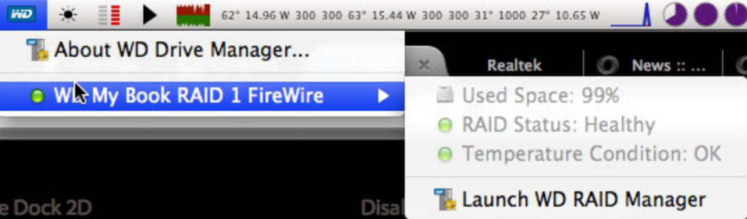

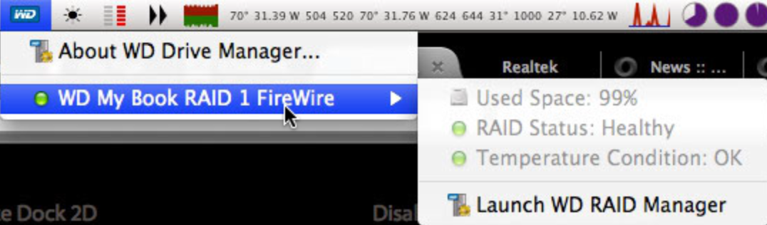

[Editing to show how the first thumbnail was also during full power, no-nap mode; the second is slowpoke-and-chill mode.]
