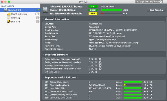

So the battery needs replacing and Drive DX says this about my SSD in my mbp 2015. Is it worth fixing? I am guessing not. Do I need to hurry to get a new one? Im a teacher and trying to weigh options

You actually have THREE, not two things that are failing:
  1. The two Western Digital drives (as said in your original post)
  2. The battery
  3. The SSD
All will need replacing eventually, so why not just implement something right now?
Replacing the SSD is probably going to run you $60-80, depending on the size of the drive. Replacing the battery is $129 I believe, maybe it's more, you'll have to look that up for your particular model.
Also, if you don't think it's worth it, just get a new MacBook.

Your SSD needs to be replaced urgently. Or failing replacement get a decent external sSD as boot disk.

I'm wondering what it is you do or use that could cause that amount of "consumption" of the internal SSD in 7 years?
Might be time to start considering a replacement.
