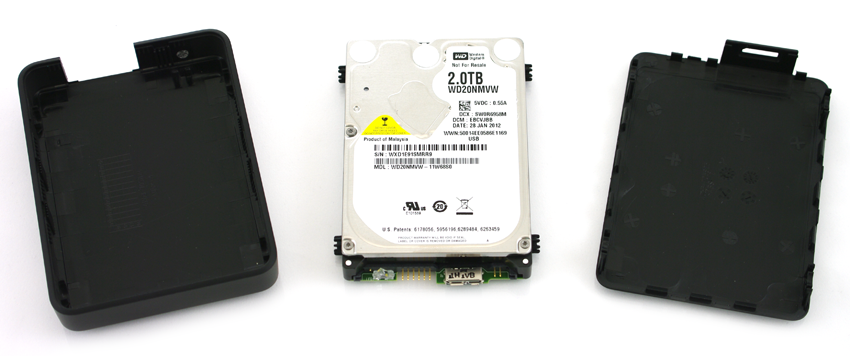

One other thing, may be relevant to you, may not be.
I have _heard_ from others that in some cases pre-packaged drives are now coming with internal drives that do not use a "standard" SATA connector between the drive and the mounting board. Not sure whether this applies with the drive you have or not. Only way to know is to open it and check.
Not sure about 3.5" drives, but that's definitely the case with newer WD 2.5" drives:
Source
