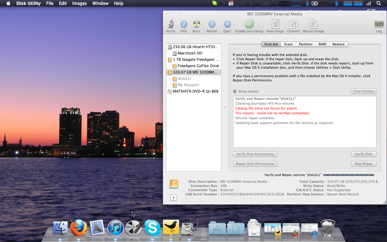

This is what is happening so far. Is this bad?
The 'My Passport' is where the stuff is, disk21k or whatever was a partition where old backups from another system is. Should I cancel the repair and select to repair 'My Passport'? Or does it no matter?

Is this one of the Raided passport drives? It's showing up in disk utility, which is good. Just remember, you will want to retire this drive after extracting the data. You also need to maintain proper backups in the future to prevent a repeat situation like this one. File or block level corruption isn't something that can always be repaired. Disk warrior fixes the directory, often making it readable. If it wasn't visible to disk utility, this wouldn't even be an option. Data Rescue is another possible option. If it wasn't showing up at all in disk utility and wasn't a raid controlled external drive type, I'd say you could always try the bare drive in another enclosure. I would not suggest that here. It only works if it's just a drive + bridgeport, and if it works as is, that is your best chance. Trying different cables is pointless here. You've mentioned it having been dropped on multiple occasions. It's doubtful that you have a cable issue. Remember any drive can die, so you need to store your data in more than one location. It's fine to store on external drives, but they must be backed up.
