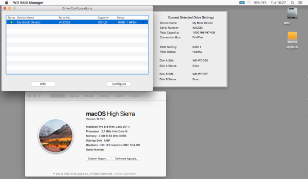

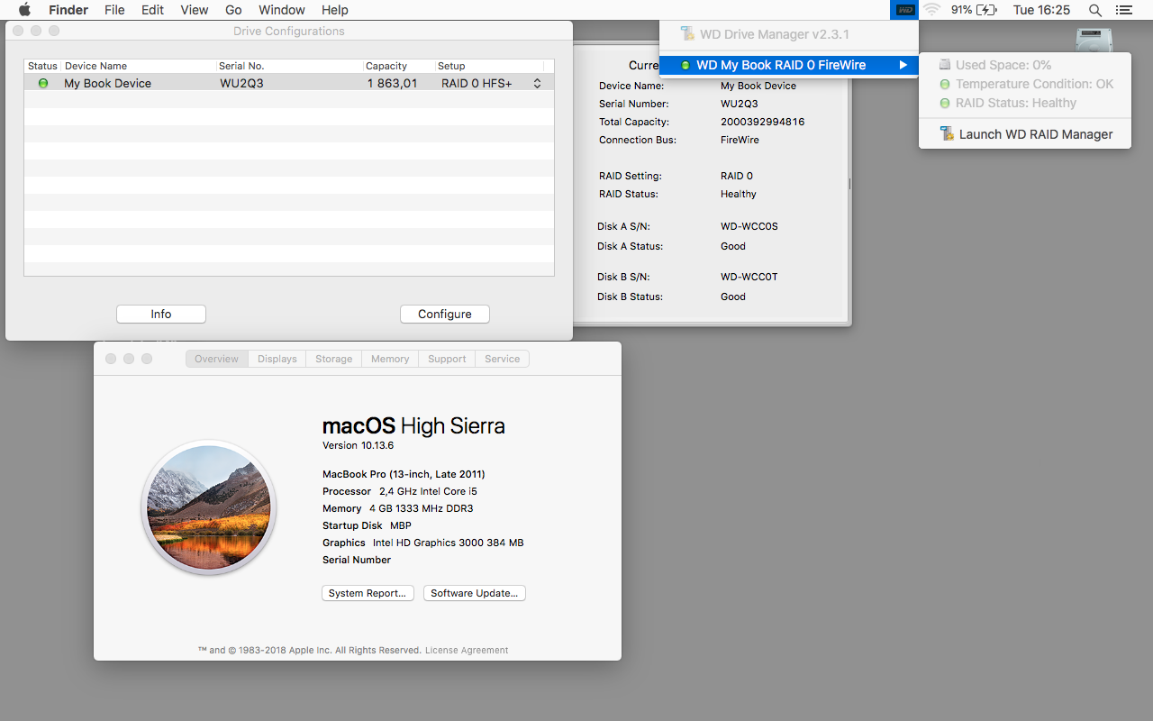

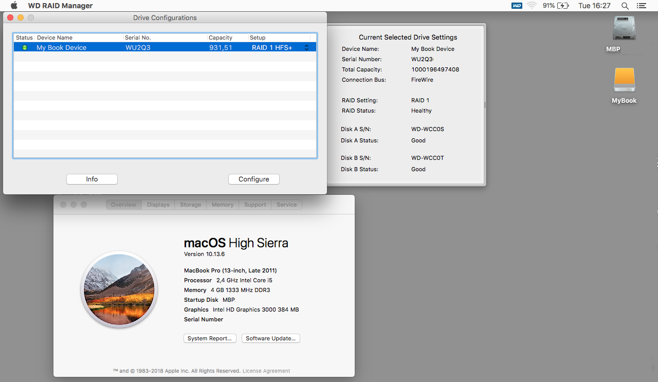

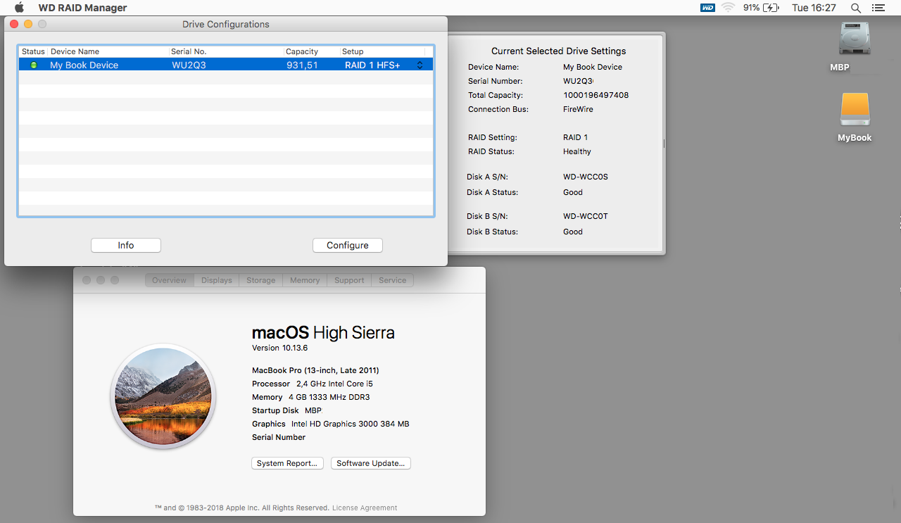

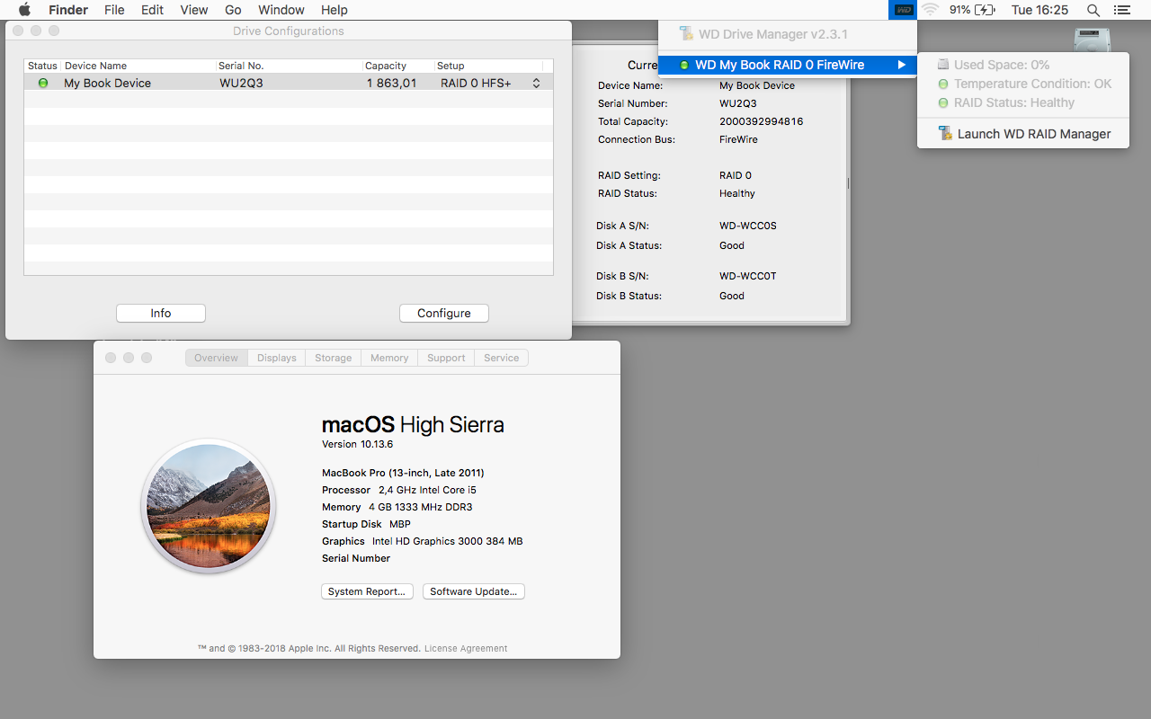

Back to OP's problem, which, as it turns out, is not a problem at all.
I was fiddling with High Sierra (yuck!) and decided to check whether WD Raid Manager really can not be installed on HS. No, it can! 😉 High Sierra complained after installation that the app is outdated, but that's all. I was able to change configuration to RAID1 and then back to RAID0. The only difference from the 'regular' High Sierra on my machine is that it is installed on HFS+ volume, not APFS.
By the way, if anyone ever manages to brick his/her My Book Studio II, just PM me. I have a solution. And no, there's no money involved 🙂 It's just that I don't want to publish this stuff.
I have WD Studio II and cant change RAID status on Mac OS Monterey. Have you any solution for this issue?
Best regards, Nenad
In order to do that you have to use WD Raid Manager and OS that supports 32 bit applications. You should be able to set it permanently to RAID0 or RAID1 in older OS and then use it on Monterey, I think.
@Lahezis please report what the results are. It might be useful for someone in the future.
(I don't do anything past HS, so I have no way to verify it).

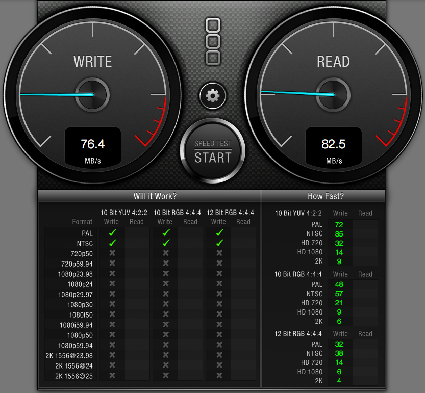

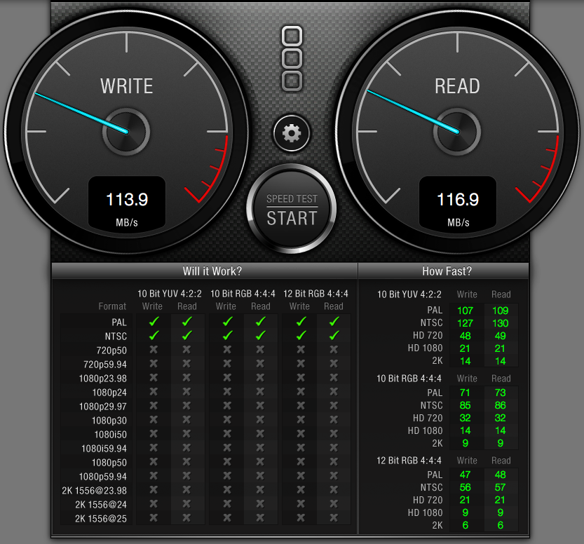

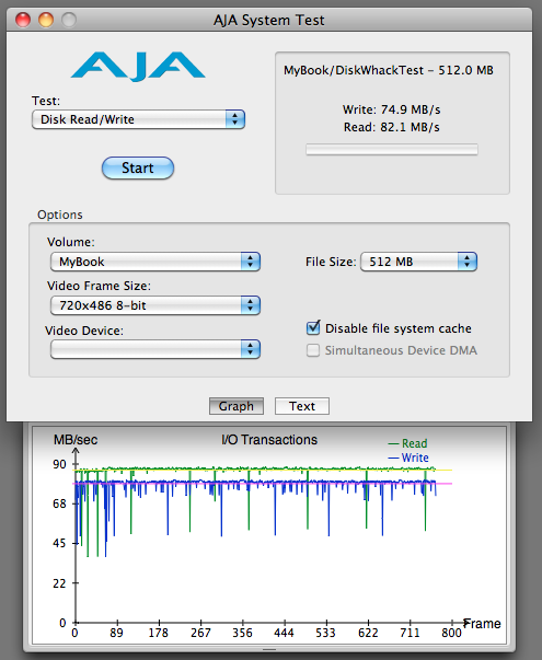

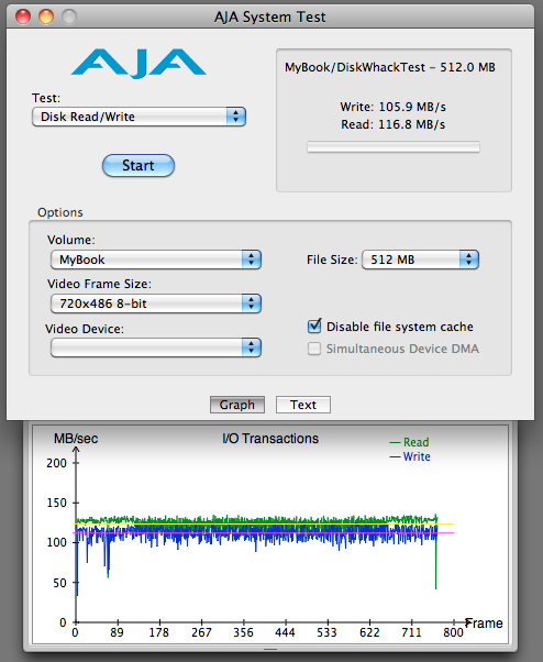

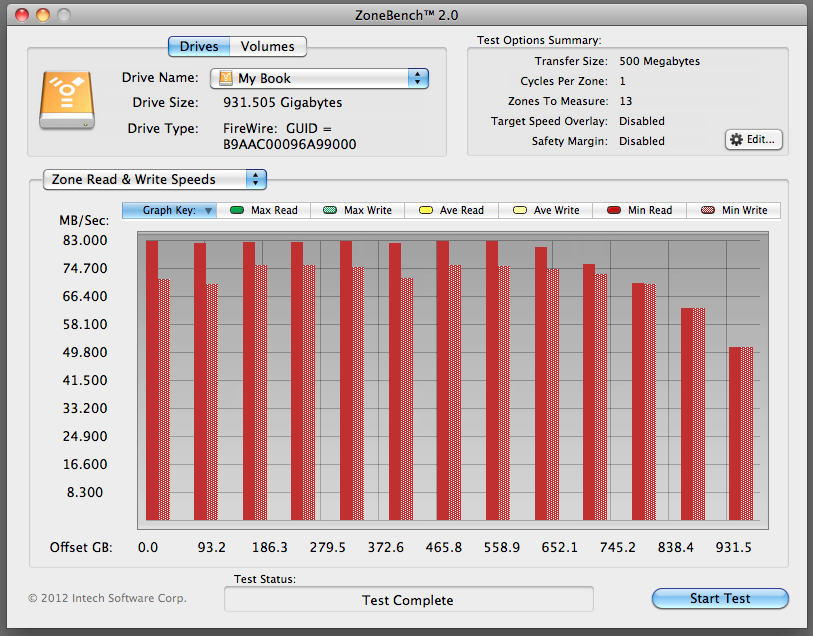

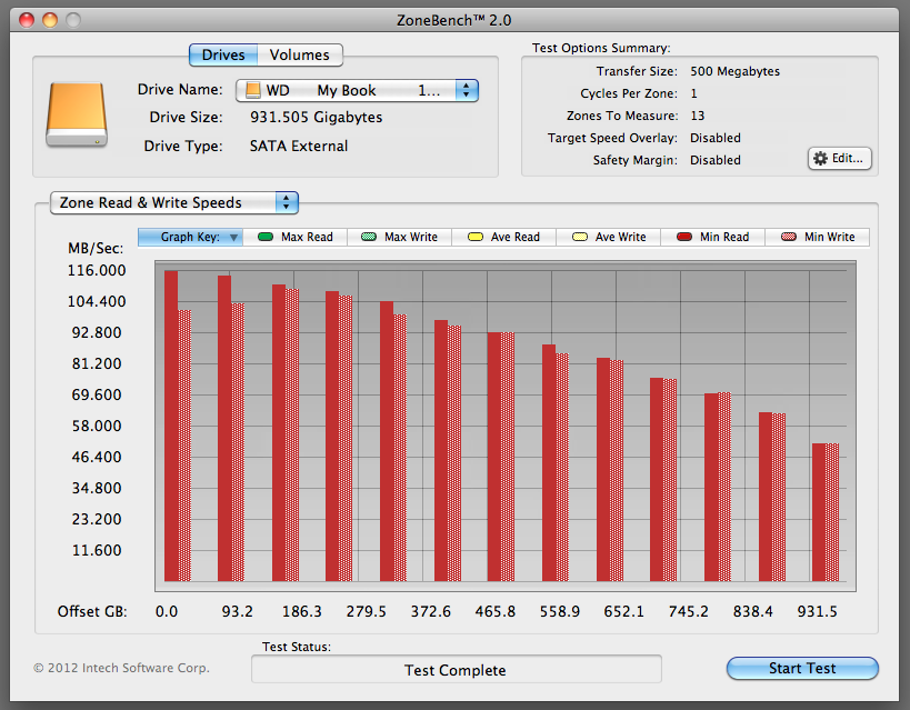

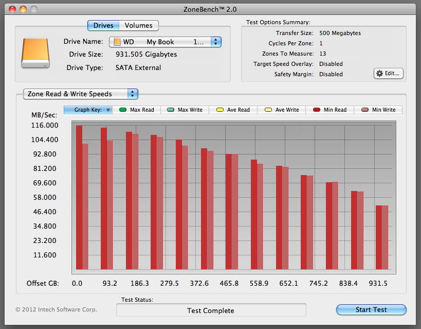

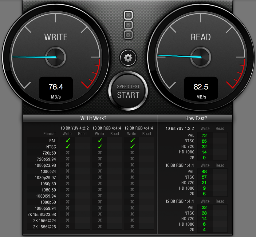

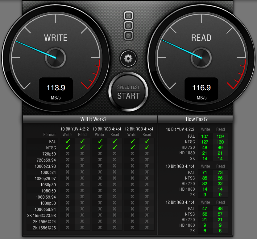

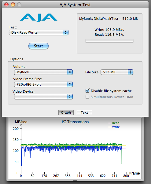

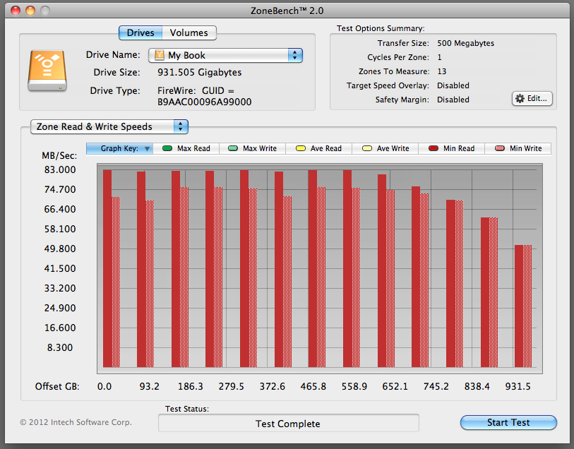

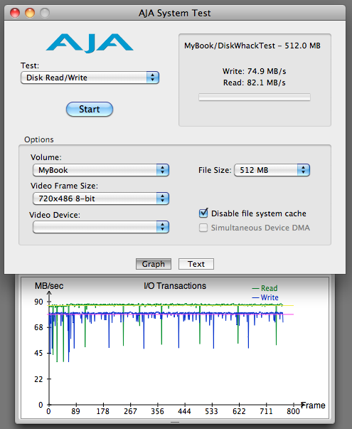

Bought myself a new toy - LaCie Thunderbolt to eSata hub and decided to speed test WD My Book Studio II with its original 1TB drives in RAID1 mode using eSata port. Since Thunderbolt is faster than eSata, this test shows the true speed capability of WD MBII. The results speak for themselves. Not bad for the old Green drives, I have to say.
Why is all that? Well, there are USB3 to eSata converter cables (with some electronics box in the middle) available and those potentially could allow to use WD MBII on machines that only have USB3 ports. Gained speed will be a bonus.
The minus is that one can't configure RAID over eSata, this has to be done using USB2 port on the enclosure and using OS that can run WD Raid Manager. Do that and then move the enclosure to whatever machine you have.
