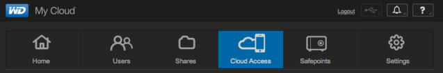

The MyCloud comes by default with some "Shares" that act like partitions or folders, where you can store things, and you can create multiple users and determine who can access what.
If you connect to the dashboard with the user that has the privileges to administer it you can verify that everything is setup like you want it to be.
