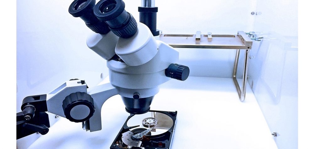

At this point I'm looking for recommendations for a data-recovery company? Is it realistic to think a "professional" can retrieve my Photos Library? Or is there something else I could try? Thanks guys!
Try this one. They're reasonably priced.
