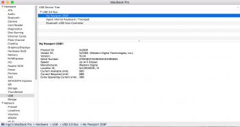

Hi Guys,
My WD my passport external hard drive is not showing up on my desktop.
Also not in disk utility. Only in system report.
What can I do to make it work?
If you have any suggestion kindly share.
Thank you
If it's not showing up in Disk Utility and won't mount, then it's probably failing. You can try unplugging it and plugging it back in several times to see if you can't get it going again. If that doesn't work, it's probably time to call WD and get a RMA if the drive is still in warranty. WD Passport drives are warranted for 3 years.

Now, it seems that you have a drive enclosure, but nothing is responding inside the case, other than the interface chip.
In that USB bus screen shot, you should see some information about the configuration of the drive, capacity, file system used, some other info. But --- there's nothing about the media at all... just the interface data.

Even if a password were needed, wouldn't you still see information about the media in that USB tab?
And, you would also see the media, even if it wouldn't mount. OP said it was NTFS format, and Paragon NTFS would provide for the password access directly in Disk Utility, right? And, you would still see a volume there, too. OP has nothing.
