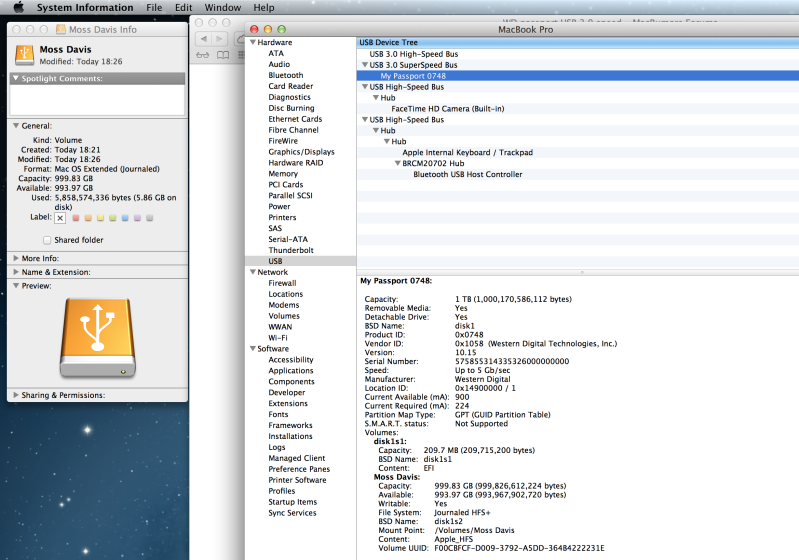

What about the rest of my questions? Did you use the USB cable provided with the WD Passport HDD? Did you format the HDD? If not, go to Finder, press CMD+SHIFT+C and select the external drive, press CMD+I and tell us, what it says after General > Format:?

Yeah I formatted it from FAT as I need files bigger than 4GB, as you can tell I don't know much about HDD's 🙂
Picture here

Try the other two, to see, if you get similar speeds? Have you tried the HDD on both USB ports? If it is still not going as fast as it promises (30 MB/s is USB 2.0 speed and even a slow 5.400 RPM HDD is faster nowadays), can you return it?
