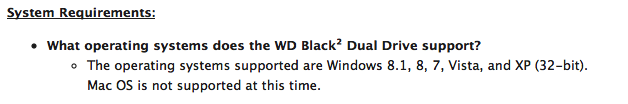

The caveat is that WD specify that Macintosh is not supported, but is that correct?
How would OSX Disk Utility handle the Black2 on first installation? Would it report the disk as faulty and then ask the user if they wanted to enable Fusion Drive?
http://www.wdc.com/en/products/products.aspx?id=1190
Straight from there site.
I'd say its true and you're only going to incur frustration and headaches trying to make it work, if they state its not supported.

But the drive itself is not supported in OS X...

I think these drives differ from the Seagates because they are more or less two actual drives in one casing as opposed to an all-in-one. I would suspect any incompatibility would be directly related to the firmware.
Ah I see, I should have taken a closer look at the page; in that case it's a very weird product, as it sounds like the whole thing is software controlled. So to OS X it'll just look like a 128gb SSD and no-more, since the software to access the other disk won't run.
Very, very strange though, as OS X should support a SATA multiplier to access both disks, so it seems strange WD wouldn't be using either that, or some kind of onboard controller to manage the pair on your behalf (just using software to change from a standard configuration).
In that case, yeah, it just won't work for OS X, and since it can't dual boot it's only useful if you want to use it as a pair of Windows-only drives. Disappointing! In that case I'd recommend an SSHD if you really want just the one slot in use to free up space, but otherwise a standard two disk Fusion Drive is simply better anyway, as you're getting two SATA interfaces instead of one.

To make a long story short: Is WD Black2 now supporting OS X, or not??? And if it does, can we mount this in one slot in MacMini (late 2012) and mount a second drive (SSD or HDD) to the other?
Yes, it now supports OS X natively. No need to configure via Windows.
Yes, you could use this and another drive.
