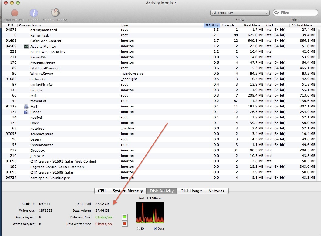

Hi Guys, quick question. I just noticed that in the Activity Monitor it shows that in the "data written" section that I have written 37.44 GB in a 12 hour period.
Wow, 37.44 GB written in @10 hours of use, and I didn't do anything "write intensive" other that have Mail, Safari (5 tabs open), and BackBlaze running (it had finished uploading my computer 2 day previous).
At this rate, I would be writing @ 75 GB a day and I know that SSD's have a limited amount of lifetime writes 🙁
Can anyone enlighten me on these numbers and see what is being written?
Note: Apparently SSD's are good for a limited number of writes, some figure like 10 TB, so at this rate my 250Gb SSD 840 Evo would wear out in short time.. 🙁

SSDs are rated in thousands of cycles ie. a complete write of the drive is considered a cycle. In your case roughly 3.5 days per cycle if your drive is rated for 1000 cycles then you have 3500 days at your current rate or roughly 10 years to go. BTW I see nothing there in that picture that shows/says per day total could be since last boot...
I looked in About This Mac and saw that it shows your last reboot time, and I noticed that in the attached jpg, the Activity Monitor shows how much data was written or read since your last boot-up.
It just seems alarming that in a 10 hour period that I wrote 37Gb and I wasn't doing anything write intensive?
It just seems alarming that in a 10 hour period that I wrote 37Gb and I was doing anything write intensive?
I agree, that is odd for the usage you describe.
Were you running any kind of backup or copy to external drives? Just from a quick test I did here it looks like that data read/write total is for all local drives. So if you did a 20GB Time Machine backup to a local USB drive that would increase the data written by 20GB.
There is a good article here with some lifespan data on your EVO drive. Yours would be that 23.4 years to the right at 10GB per day.
BTW if that isn't clear that number is from all writes. That includes backups and flash drives. Your timemachine backs up 7GB to the external that is 7GB more for the stat but no write on the ssd.

I just noticed that it appears to be BackBlaze that is causing all these "writes". My initial backup to them finished last week, so I will try to use their scheduling feature to reduce the constant disk trashing.. 🙂
