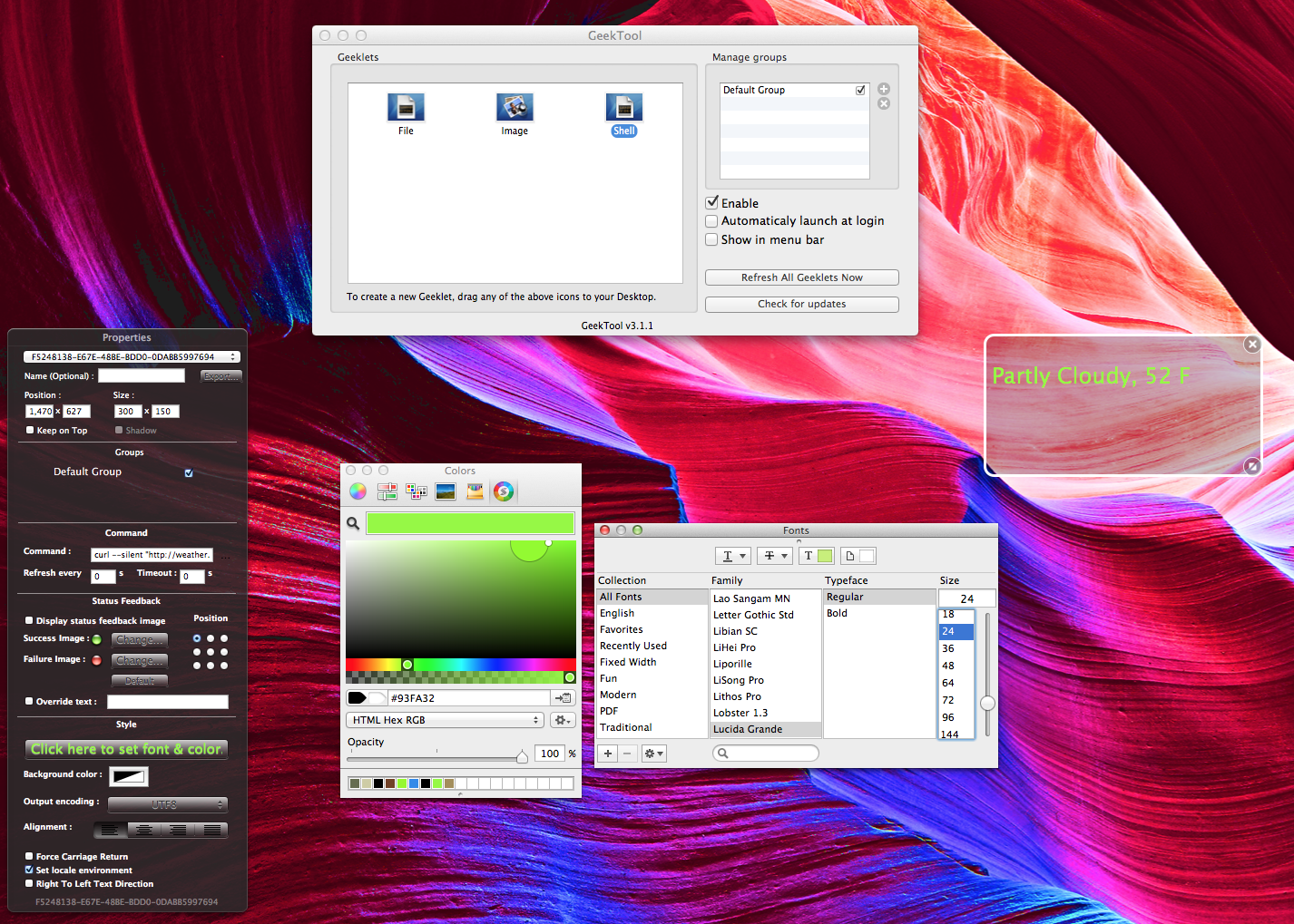

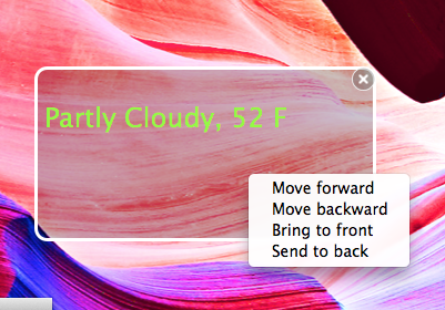

Have you moved it behind another geeklet possibly? Been there, done that myself. As you can see from my screenshots below it is working fine and you can right click on it and move it to the front if need be. Possibly try remaking it again may be another solution.
