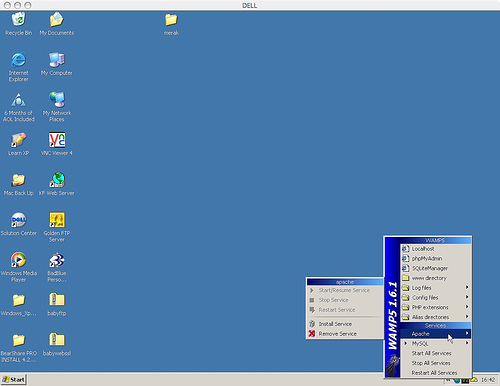

Not easy enough, It installed and it's sitting in the task bar but it wont let me install Apache services. Also I have put the iWeb site in the www folder but when tell it to open localhost it just brings up a page saying that the apache site was not found.

Just from the menu in the task bar, I click on Install Services (under Apache) and nothing happens.
Apache is installed right from the start, you should not install any services.
Just install the wamp exe and put your files in the www directory and the localhost should work.
If you got an apache error make sure you have pressed "start/resume apache services.

Stop and start are greyed out, that's why I'm trying to install the Apache services.
xper said:
Again, you should not press the install service text.
Is both start and stop greyed out? Seems a little bit od.
Does it not look like this? www.x-per.se/temp/wamp.jpg ?`
Tried to restart all services?
Nope, it looks like this (Image attached).
And yes I have tired restarting all services.
