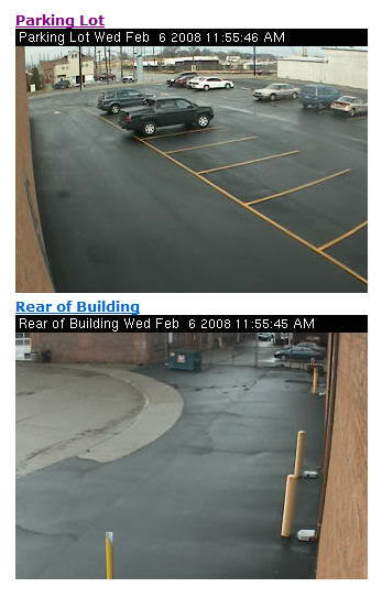

I use Axis cameras at my office. None need a PC. They are all connected into my network and then I created a webpage to display all 6 at the same time but you can also just access them by using the IP address of them. You would need to have your router set up to port forward to the internal IP address.
Here is a screenshot I just took of the 2 outside cameras (they are my newest ones). These are Axis Model 211 and they are in an enclosure. I really like them. They also have it in a wireless model.
