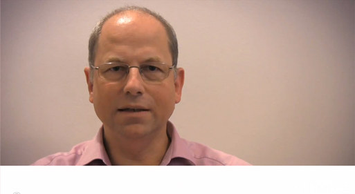

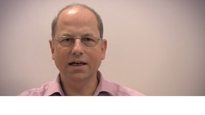

Here's an example
The one on the left is the original RenderFile
The one to the right is the youtube upload (oversaturation)

looks like a conversion issue. The more you compress an image the less information is stored in each frame. So there is less color information.
Its not so far off. try applying a filter in whatever compression program you are using and decrease the saturation by 5-10%. That should help.

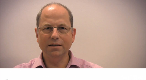

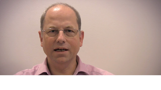

Here's an example
Not that you asked, but both pictures look reasonable to me on my monitor ( 27inch iMac i5 2010 )
Yes, the one on the right is warmer. I would just chak this up to Youtube recompressing the video and further mashing up the colorspace.
Unless color accuracy is extremely important for your videos, I wouldn't sweat this. It looks fine.
