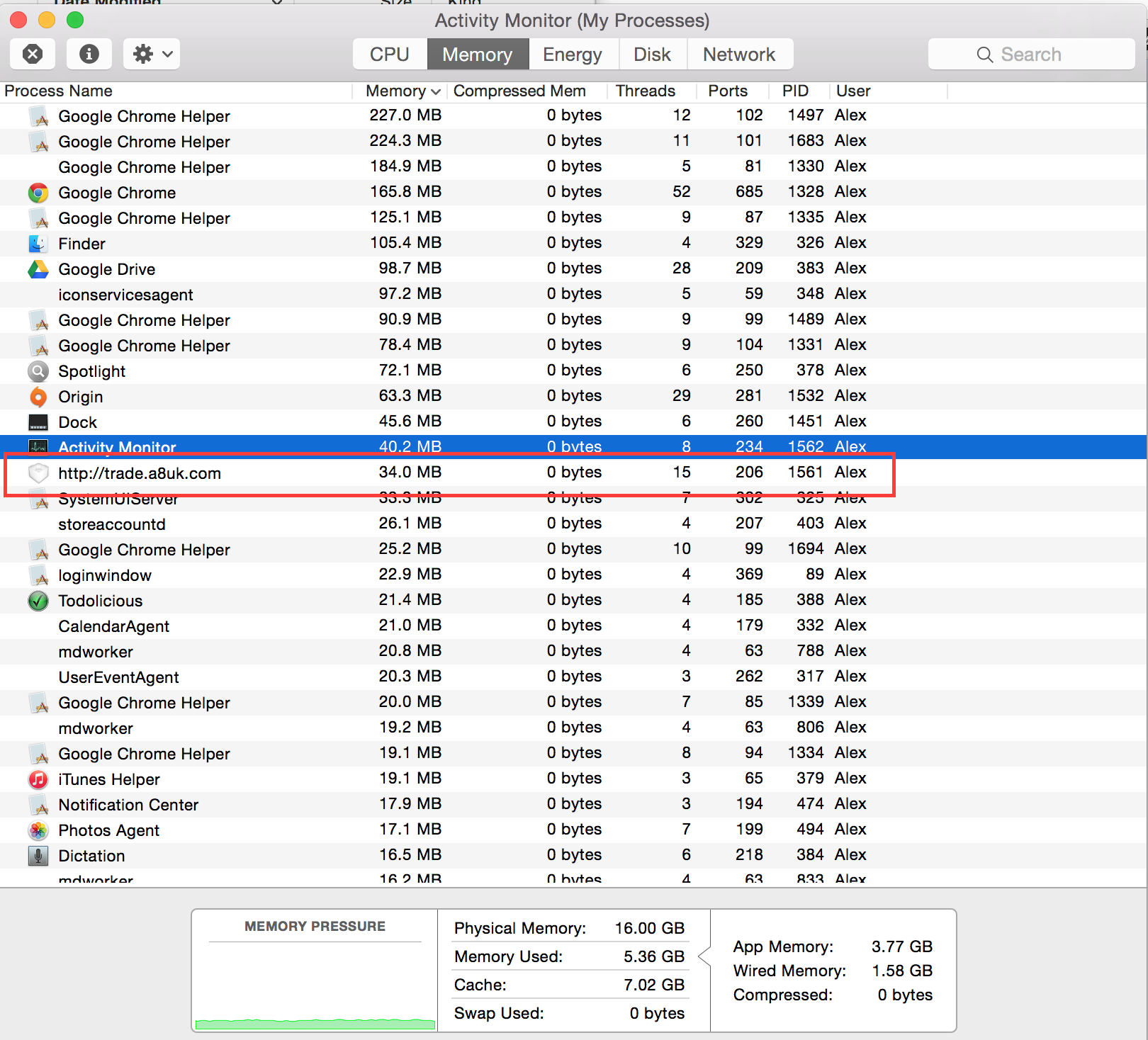

Anyone know why or how there is some strange plugin in my activity monitor? Want to delete/remove this permanently?!
Screenshot Attached.

I have seen something like that show up when I have been logged into it. For instance, I see "https://forums.macrumors.com" show up in Activity Monitor when I am logged into my user account. When I log out it does not show up any longer.

I havent ever logged into that website address. Any ideas?
You're using Chrome, so look for it in Chrome's Task Manager:
https://support.google.com/chrome/answer/95672?hl=en
If it's listed there, then control it from there. That task mgr should also identify what kind of process it is.
If it's not listed in Chrome's Task Manager, then use Activity Monitor to discover the process's Parent Process ID (PPID).
It should be listed for the process when you get info on it. Try selecting the process and clicking the circled-i icon in Activity Monitor's toolbar. If its PPID is Chrome, then it's a Chrome process that Chrome is somehow failing to manage. If its PPID isn't Chrome, you can sort the processes in the list by PID (Process ID) and learn who its parent is.

Thank you for your help, turns out to be spotlight search suggestions;
