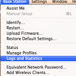

Have you checked the logs in the Airport Utility to see if anything strange shows up?
BTW, I love you signature. 😉
LOL, thanks.
Yes, I checked the Console but your shot reminded me of that menu and lo and behold...
