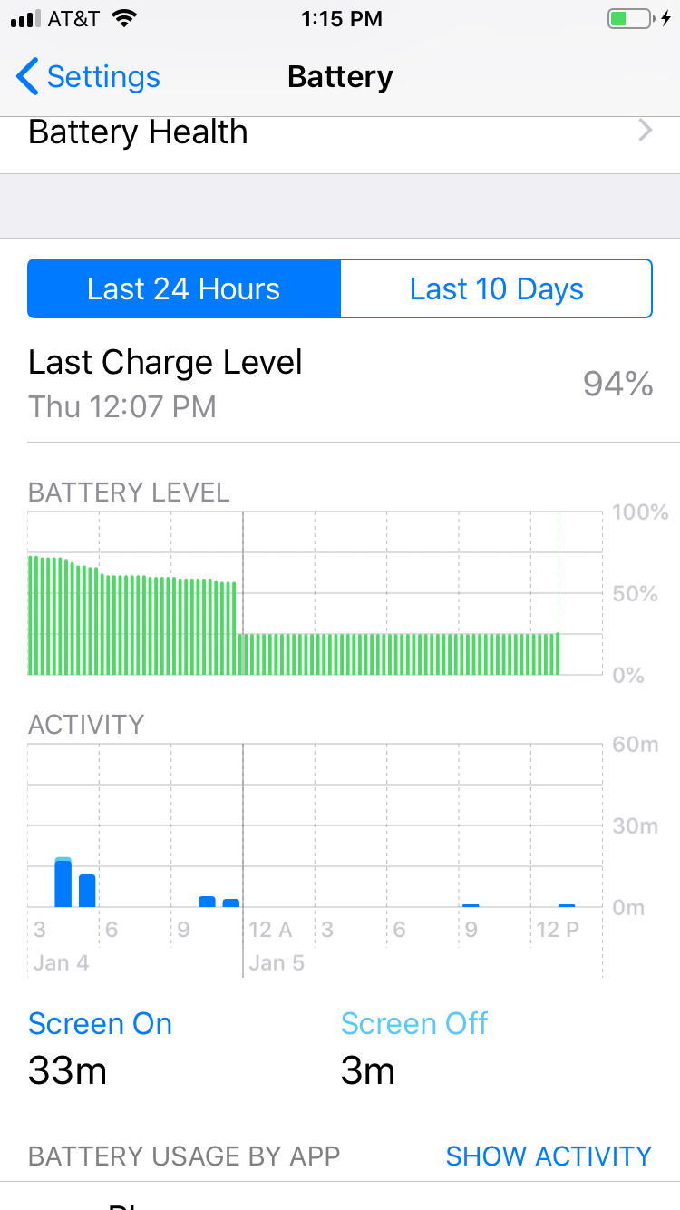

My mom was complaining that her phone battery was lower than it should be, and when I checked the graph I saw this. It looks like the battery suddenly jumped from just over 50% to around 25% around midnight for no apparent reason, and stayed exactly there for many hours. She didn't use her phone around that time at all.
Is this a sign that the battery is failing, or just a bug in iOS? Anyone else seen this before?
It's a slightly over four year old iPhone 6.

It's not battery failure, it's the "digital battery level gauge" out of calibration.
Run the phone down until it almost shuts off, then charge it all the way back up to 100% without using it - use the standard slow/tiny apple charger. Not a fast charger.
Do that again one more time and the battery level meter should re-calibrate.
But don't make it a habit of running the battery down that low in the future. It's hard on it.

I had the same during new year hoildays, I was in a place completely out of cell signal, phone in airplane mode all the time, and it went from 80% to 65% overnight, showing the same gap in the graph, my battery health is currently at 92%
