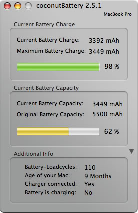

Since I really don't know what I'm looking for, how am I doing? Looks a little low to me, but again, no clue. And the 98% is full charge while plugged in.
you might have good ground for a complain, your battery is at 62% health (from original capacity), since it seems it's only 9 months.
But he also has 100+ cycles...
Apple may not let you exchange for a new one because of this, but it definitely worth a try.
Even after 100 cycles it should not be that low. I had an iBook that had 100+ charge cycles and was in storage for 9 months and it had 83% capacity when I checked after the 9 month storage period. Apple should give them a new battery if it's that low.
Well, it sounds like I'm making a trip to the Apple Store then! 🙂 Any suggestions on how to go about convincing them to give me a new battery? I have a few issues I brought to their attention a while back, but they refused to take care of it and I caved.

First try the store and be firm but not demanding. Also, I have found that AppleCare is easier to deal with over the phone.
As for convincing them, tell them that your max capacity has dropped drastically over the last couple of cycles.
Update: I went ahead and called AppleCare (because the store is a little over an hour one way) and they are sending me a new battery.
