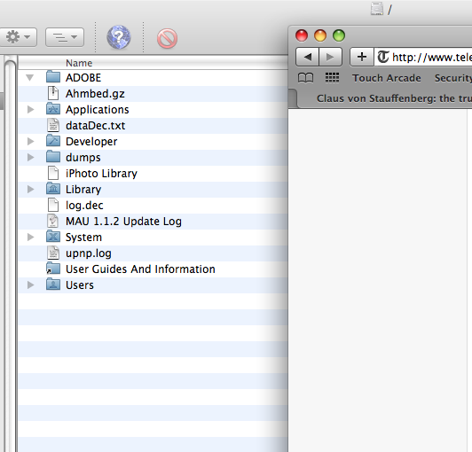

I noticed that I have blue/white stripes in the finder window on my macbook but when I came to calibrate my 24" ACD on my MacPro these blue/white stripes arent there!?
The strange thing is that if I move a window over the finder window, where the shadow of the window above would be cast, I get the blue/white stripes.
The monitor calibrated fine and it was like this before calibration but I thought I should plug in a second monitor to see if it was like it on that one. When I plugged the second monitor in, this was fine but then I looked at the ACD display and it had fixed the fault!? I had a full compliment of blue/white stripes.
Thought nothing of it and rebooted after the safari update and here we are again, same fault is back.
I am sure this is a software issue and have attached a screen shot.
Another strange thing, when I was making the screenshot with shift+cmd+4, underneath the whole shadow cast from the selection I saw the blue/white stripes (it took a s shot of the plain background though).
Anyone any ideas? its annoying 🙁

To recap:
Reboot Mac = no stripes
unplug display and plug it back in = gives me stripes back
maybe there is a prefs file i could delete? doesn't explain why when I disconnect and reconnect the display it works?

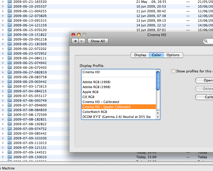

omg, now the plot thickens!!!
I just noticed (after I have unplugged the display and plugged it back in to get stripes) that I can now see stripes on the jpg's I attached above!
So, now I am thinking there is an issue with the display itself maybe? otherwise why would I not see the lighter blue part of the stripe?
I have looked extremely closely and it is a solid white background apart from where the shadow drops from above. I will attached a photshoped image of what I see in a sec.
When the fault is apparent this is what I see.
Both realtime and when viewing the screenshot files.
beats me!
