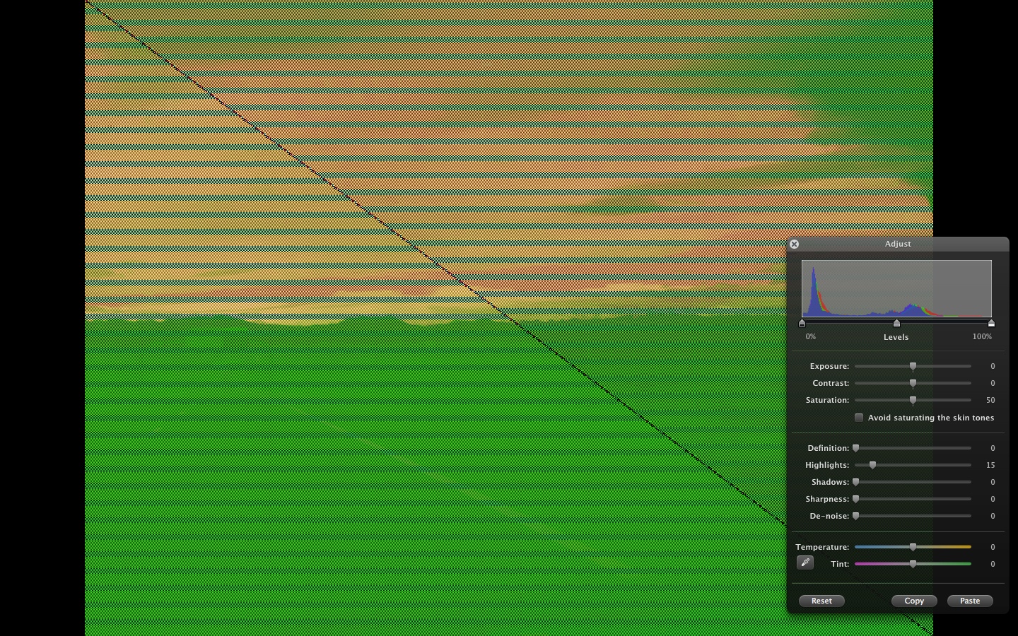

This has happened a few times before, too. In iPhoto, when editing, the screen goes green like this, and I have to back out of editing, and the picture reverts to the original (even if it was previously edited and saved successfully.)
I'm thinking video card. I'm also thinking my machine is dying, and swapping the HDD won't be the fix. Thoughts?

Your internal hard drive is dead/dying. Problems on the SATA and EIDE busses will prevent option+boot and other things from working correctly. The computer is waiting to receive information from devices that have turned on, such as your dying hdd, and since they are dying they either do not give the requested information or do so with errors, thus slowing down EFI's ability to boot at all correctly. Seen it a dozen times on macbooks with bad hdds, and with alumiMacs when their Opical drive is dead.
As far as iPhoto's inability to correctly render its output, this is more likely an iPhoto problem, or rather a corruption of data. Could try rebuilding the thumbnails and what not by holding option while launching iPhoto. (I think)
If it were graphics card problems you'd be seeing evidence in other places, such as kernel panic log backtraces to the graphics card driver. Or corruption while doing other things. For instance why is there no corruption with the alpha overlaid adjustment bar?
Because there isn't a graphics card issue.
